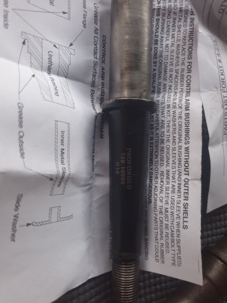

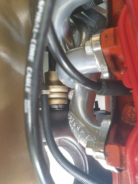

I installed PST greasable poly bushings into my Lower Control Arms about 6 years ago. They say "Proforged" on the shaft.

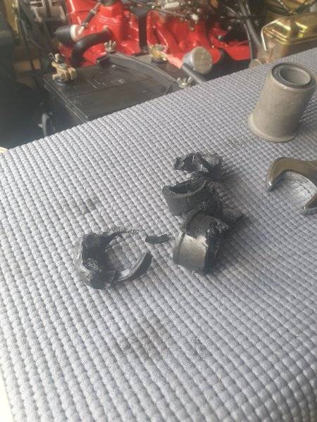

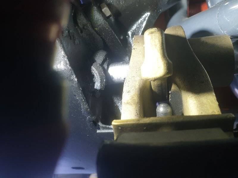

I noticed last week the passenger side shoulder of the bush was all split, and checking the driver's side from underneath I could see that one was stuffed too.

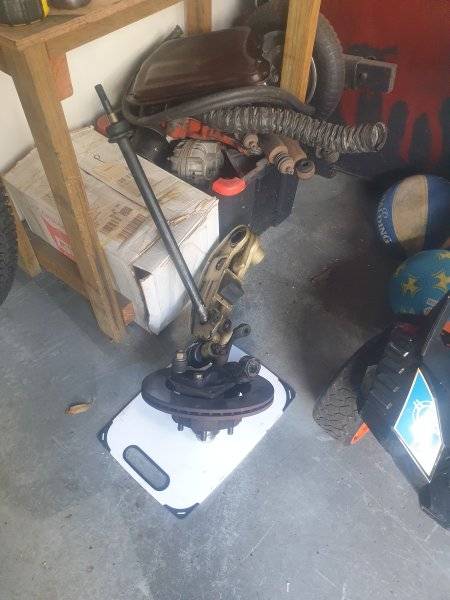

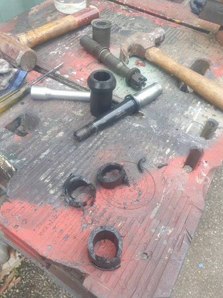

This morning I pulled the driver's side LCA out and it's a right mess. I kept as many parts on as possible to reduce the time in removing it all but nearly couldn't get the LCA off as it was hitting the header, but I jacked up the engine an inch and it slid right out. Keeping the rotor and strut rod on did increase the weight a fair bit though. The shoulder was all torn up and the bushing itself inside the LCA was twisted and in pieces too. I'm sure I installed them properly at the time, greasing the inside and the outside of the bushing, so not sure what went wrong.
Luckily I have a couple of spare greasable poly bushings as well as a couple of original type rubber bushings and the original shafts, so I've got options.
I admit I'm leaning towards trying the spare poly bushings again as I can install them myself pretty quickly. If I go the other route and use the rubber I need to get the outer sleeve out which is a fairly tough job, get the old inner sleeves off the original shafts and then borrow a press to get it all back together.
Any opinions on which way to go and why the poly bushings failed in the first place?
If I get another 6 years out of the poly then I'm inclined to go that route.

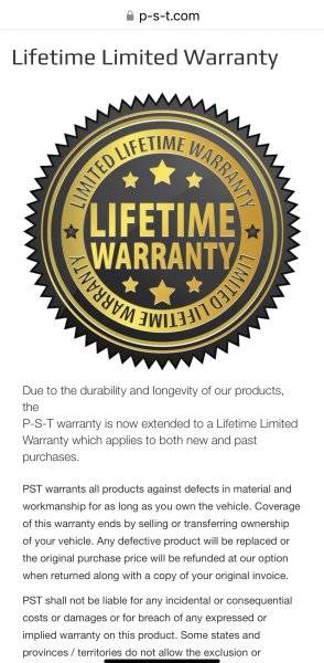

Personally, I don't like poly bushings on these old cars. I have tried them in the past, but went back to rubber. That said, I am kind of surprised of that failure with a Proforged part. I know they are made overseas, but not China. I really like Proforged stuff and think it is good quality, although I have never used any poly stuff from them. Guess I would reach out to PST first, they are pretty good with warranty issues.

You did nothing wrong. I can't attribute the failures to sunlight, high temps, overload, low temps, lack of grease, too much grease, manufacturer, ozone, color, etc, etc other than indeterminant aging.
I have had over decades, many urethane products in sealed boxes on the shelf completely fail as well as installed. My only suspicion might simply be lack of use. Hard to prove or understand how much use might be if needed. I will add one observation, urethane fails like fire ants bite, all at once, somehow.

You have the aftermarket grease type shaft?
