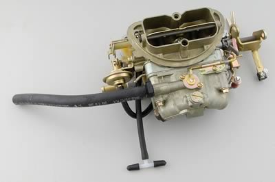

You can get all the 383/400 Low-deck BB 6bbl set up from Mancini Racing & Summit Racing, it's about near $2500 for everything new, 2 outboard 2300 Holley 500cfm Vacuum carbs, center 2300 Holley 350cfm carb, intake manifold, choke stove, fuel lines, valley pan/gaskets, vacuum hoses, coil mount, 6bbl air-cleaner & element, throttle cable & linkages, fuel filter, nuts bolts, throttle solenoid, wiring etc... it adds up pretty damn fast, you maybe able to find the 2300 Holley 6bbl carbs used "a little cheaper", but they will need work probably, they always do... The 2 x 4bbl set up maybe cheaper, in the long run, just because "one less carb" & the dual Edelbrock 550cfm carbs or the 390cfm or 600cfm Holleys, are usually far less money also...... I prefer the 6bbl set upmyself, but the 2x4bbl is damn cool too...

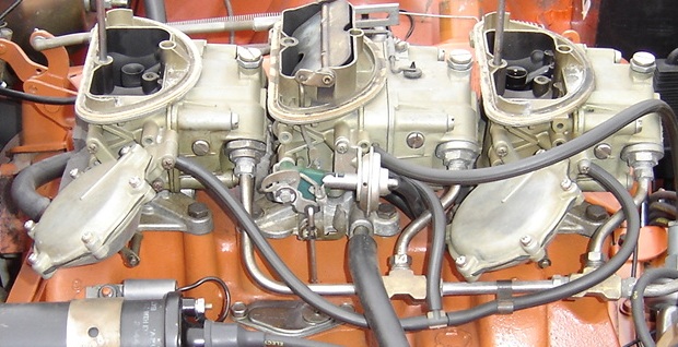

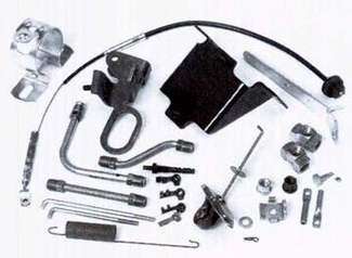

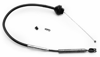

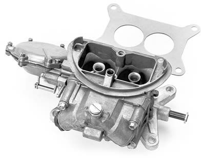

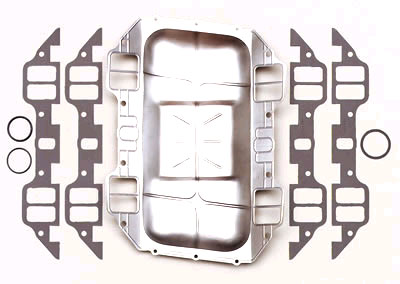

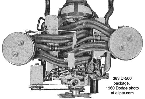

Here's a couple more 2x4bbl 383ci combos, some older, some not...

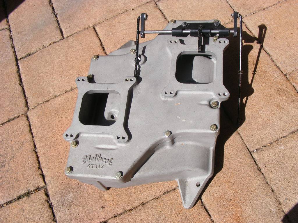

I've got an edelbrock STR 15/8 crossram for sale for a 383 with linkages if interested.
Wow that would be sick on my Roadrunner.. I didn't know they made a crossram to fit a low block... So your in Australia
Sure am... not sure if it fits those heads or not. Someone should be able to confirm it for you. They stopped making the STRs in the 70's I think. PM me if you want to know more. cheers Matt

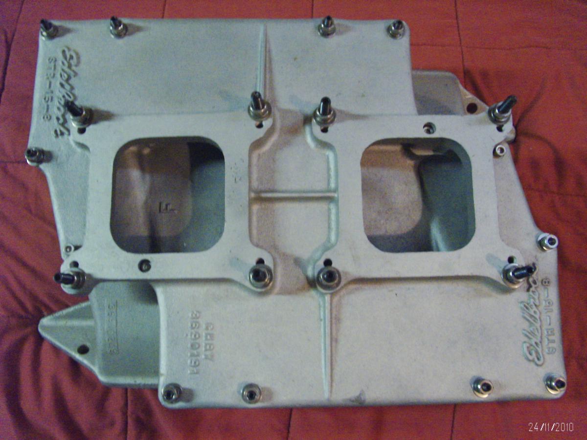

I have a Edelbrock STR 15 dual 4bbl inline for $1000
