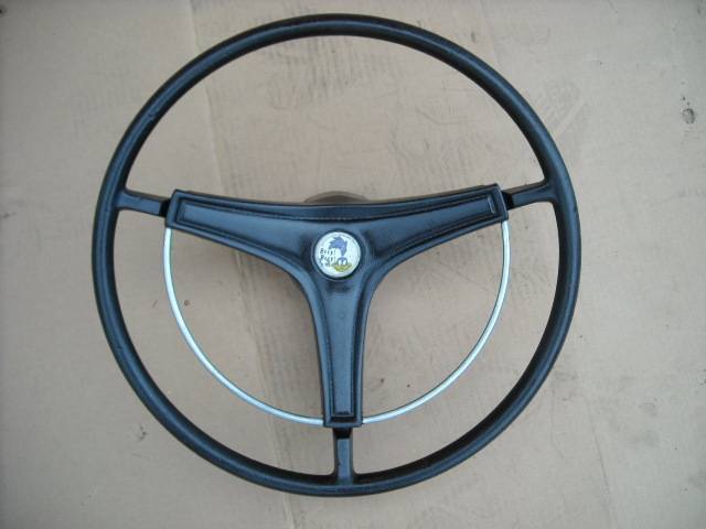

Cornpatch you have a pic of the wheel in question? If it’s this one you gotta remove the center emblem and there’s a screw under it that holds the horn ring on.

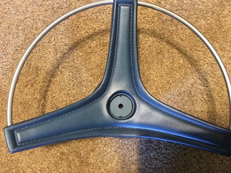

Yes one nut holds the wheel on He was asking how to tighten the horn ring. There’s a bolt under the center emblem that holds the 69’ style I posted a pic of. See the hole? The other one which should be 68’ the center pad twists off and the horn ring screws are obvious.

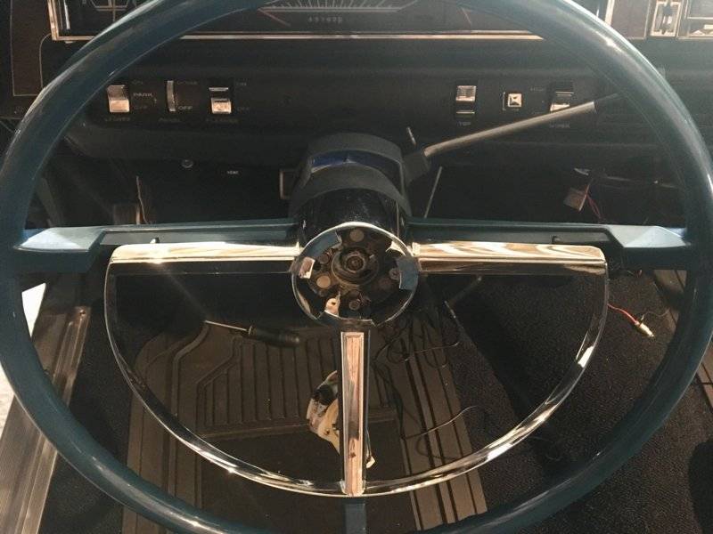

Here’s a pic of a 68’ with the pad removed.

Yes one nut holds the wheel on He was asking how to tighten the horn ring. There’s a bolt under the center emblem that holds the 69’ style I posted a pic of. See the hole? The other one which should be 68’ the center pad twists off and the horn ring screws are obvious.View attachment 981290View attachment 981289
