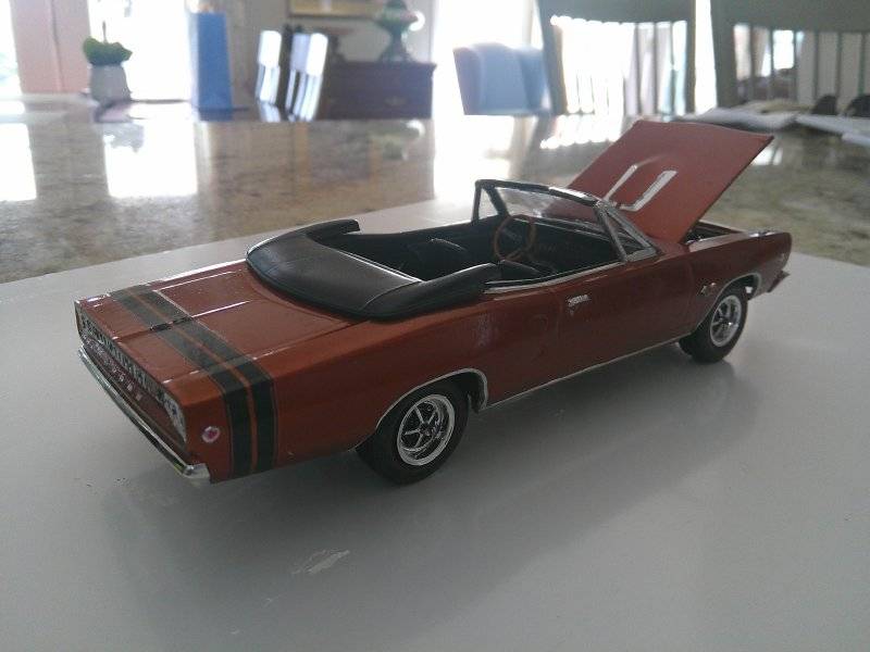

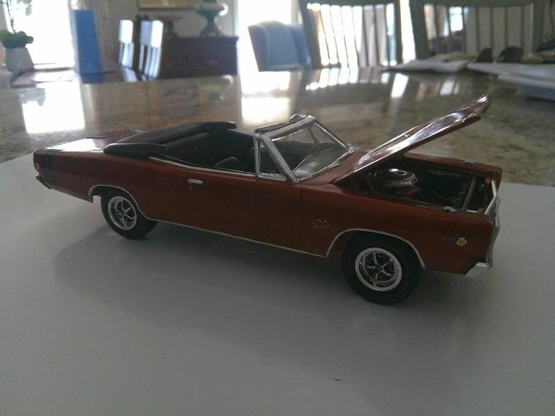

Here is my completed 1968 Coronet R/T model, Mike.

Looks great. The color looks like my RT. My car came from the factory triple black. When restoring it I wanted to change the color, but to one that was available on a 68 Coronet. Why did you do your model in bronze?
I saw a real one at MoparFest in New Hamburg, Ontario last summer in that colour and liked it.
