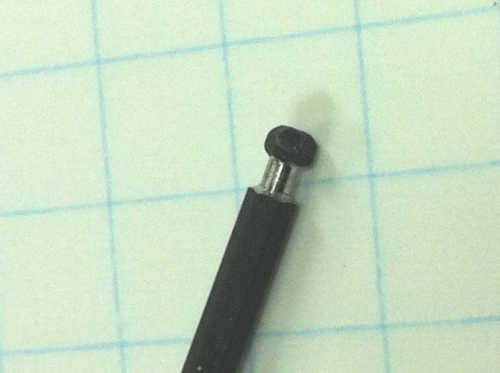

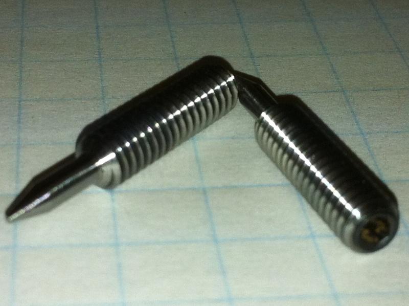

I was just goofing around yesterday in the shop and I decided to make an easier and cheaper solution to the hard-to-reach rear carb idle screws on the Six Pack setups. Those of you who know what I am talking about can appreciate this!
I am too cheap to buy the high-dollar "Competitors"

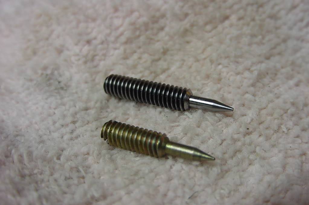

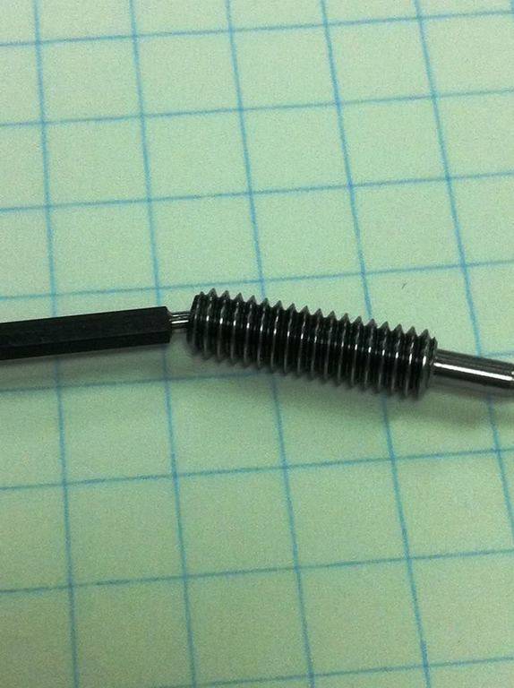

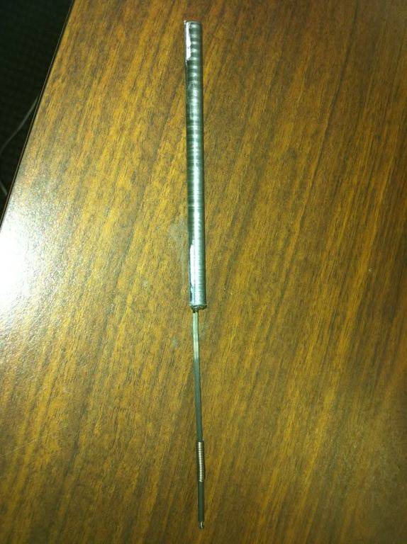

re-designed baseplate with the relocated screw location so I set out for an alternative. I took a pair of 8-32x1"lg. 316 stainless set screws and machined my own replacement mixture screws. It is much easier to get at them being that it is a 3/32" hex. I made a quick and dirty ball-end driver so that I can make adjustments with ease! I backcut the ball-end relief some more so I can get at them at about a sixty-degree angle. I have a long version that I put the hex wrench into a 1/4" diameter MDS-filled nylon "handle" which is nothing more than drilling a pilot hole and then heating up the wrench and melting it into the stock. I put an index mark on it so I could monitor the movement accurately. The second iteration is the same concept but with a stiff spring as a compliant joint to gain access with an even more acute angle.
Works like a charm!
I just thought I would share it with you guys!

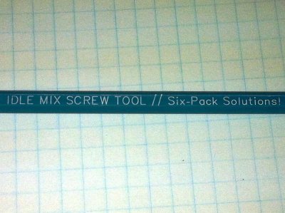

Guys, I am making upmore of these. I am tooling the handle in my CNC and I will have the prototype soon so I can send the image so all can see. The handles are going to be yellow Acetal and will be inset engraved in one area which will help indexing (think "Craftsman" lettering in the handle) and will look sweet. "Idle Mixture Adj.Tool \\ Six-pack Solutions"

Well,

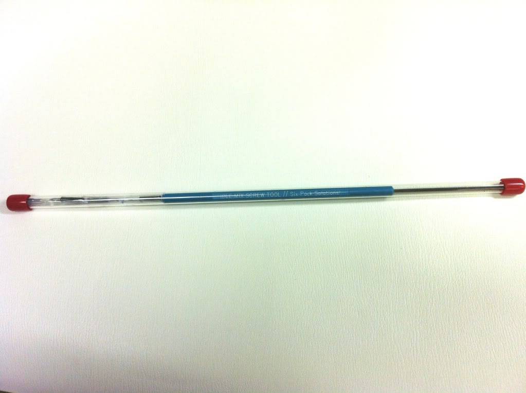

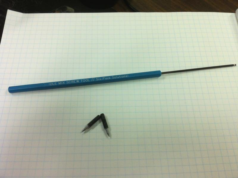

I have them finished. I used blue 1/4" OD Turcite for the handles. The overall length of the tool is 9 3/8" and is small enough to reach through the linkages and long enough to grab easily. I have decided to use the non-compliant, straight shank because it is a bit less "fidgety" to manipulate. With the undercut that I put on the ball end I achieve 25-degrees of compliance which is quite sufficient given the acute angle necessary to gain access to the screw heads. And being that my machined screws are longer it it easier to "target". The screws are alloy steel and are tough. Not that this should matter but I did it for machinability and longevity. The handles are CNC engraved in one area as to make indexing a breeze. The down side is that even though I can bang these out fairly quickly, I do not have a chucker lathe to my avail so it is a bit time-consuming to make the screws on a single post Hardinge but I have a system in place none-the-less.
I've been doing this a long time so you can rest assured that these are made right and will last.
I have four sets ready for immediate shipping (1 tool & 2 screws) and 6 more in the works by the end of next week.for those of my Mopar bretheren who wish to have these in their "stash".
I am offering these for $45.00 for the tool + the two screws and $60.00 with all four screws...and I'll pick up the shipping within the lower 48!
They will come in a mailer via USPS and will be carefully wrapped in a clear plastic tube which will serve as a sheath to protect it in your toolbox from the other tools that don't want to play nice in there!
