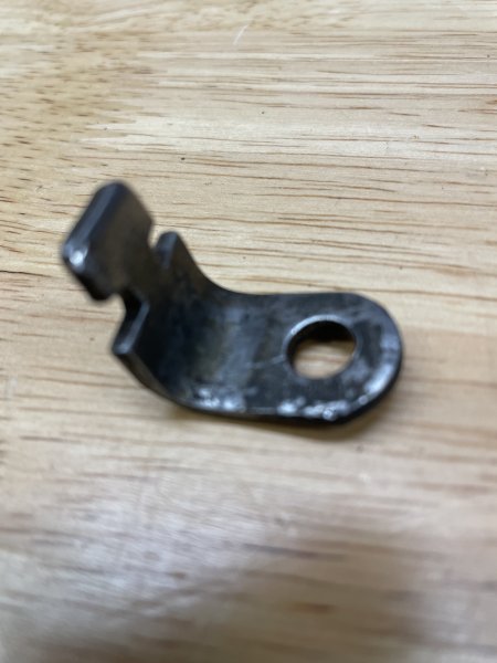

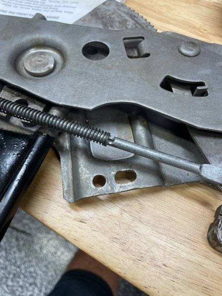

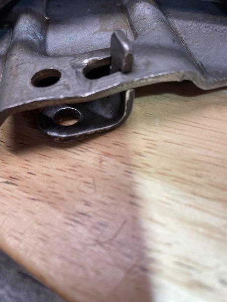

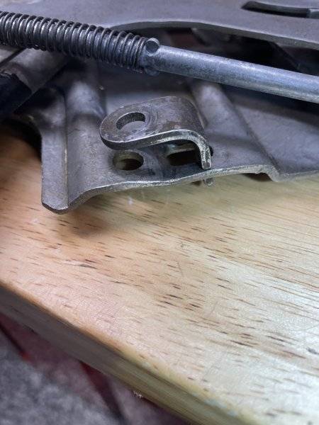

I'm in the process of replacing my parking brake cable on my 66 Satellite, I've got it all figured out but I can't remember where this part (pic #1) was originally installed. I think it might fit in (pic#2) but which direction is it installed and is there a bolt that runs thru the two holes. Any help that can be provided will be appreciated
