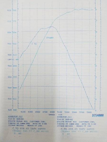

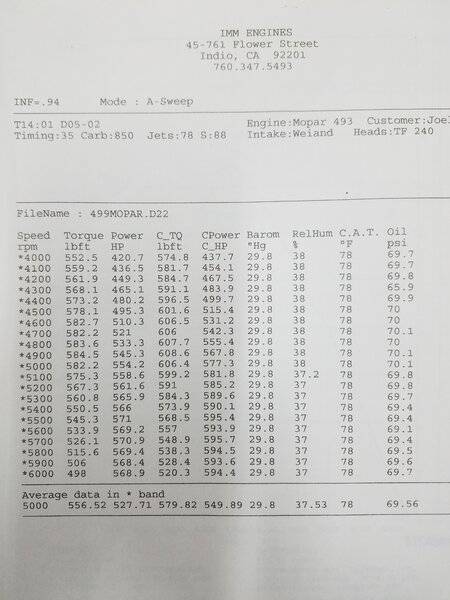

So I had a 400 based stroker built, dyno'd, and tuned by a very respected builder. He put together a motor previously for me and it is great. This one, however I can not get to quit detonating. It happens all the time when the secondaries open, no matter if you gently roll into them, or hit it hard.
He sent it back timed at 36 all in at 3400 per his sheet. MSD ready to run with 2 medium blue springs. One odd thing about this is that when I checked the timing it came all in at 2500.
He had me back the timing down to 33 and then to 30. I put in the 2 heavy silver springs to slow the timing curve to be all in at 3950. Also had me replace the NGK6 plugs with NGK7's. The plug change didn't do anything, but the lower timing and spring change did help.
He thought my Carter 6903 mechanical pump was running out of flow when the secondaries open and causing it to go lean. Hooked up my A/F meter and saw that was not the case. Yesterday I installed a fuel gauge just to verify that. Found out that my pump was putting out 10.5 psi. Replaced that pump with another used one I had here and raised the float levels back up. Did a compression test, 3 pumps on each cylinder, warm with the carb wired open.

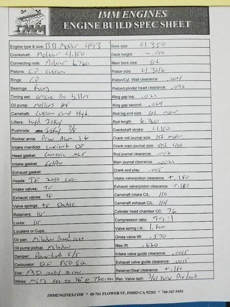

He wrote down 9.9:1 compression ratio on his sheet. Can we tell if that is about right by the numbers I got from my test? Really hoping I don't have to mix race gas because it is not readely available around hear, not to mention $8.70/gallon. He knew that it had to run on 91.

Any idea how much dish the pistons have? I'm surprised the compression is that low (9.9) with 76cc heads and .010 deck height.
Bryand
I was also wondering how the static CR was calculated, don't know the dome/dish of pistons, or head gasket bore & thickness. With a .010 deck & 76cc heads, not sure how he got to 9.9 CR.

I have no idea what pistons are in it and he just listed them as CP Custom.

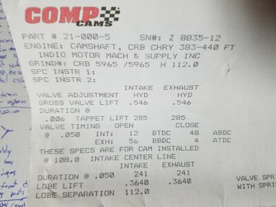

Is there any info on where the builder set the cam's degree?
I'm no expert but would having the cam set straight up have less compression than a 2* advancement? Might cure a detonation problem to not have the advancement verses straight up?
I read somewhere to just do 3 revolutions of the motor also, so that is what I did. Apparently this one maxes out at 4 like you found out too.
The lobe separation is 112. Not sure if this is what you ate asking about? This is all Greek to me as I am only a lowly HVAC guy.
