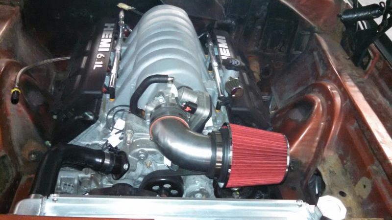

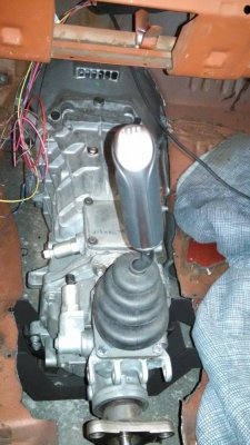

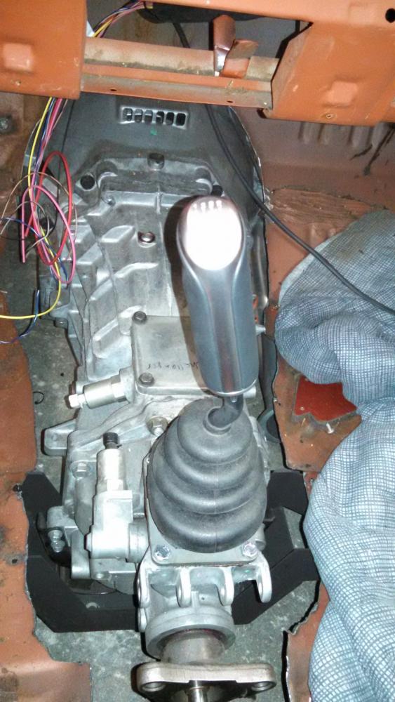

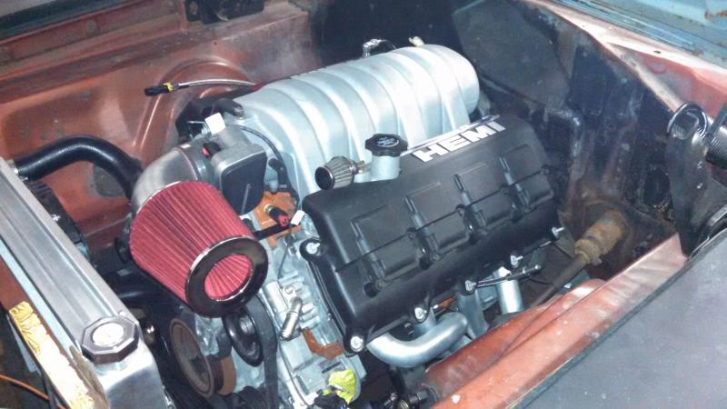

It all comes down to how bad you want it. I got way more money into mine than i want, but i dont regret it one bit. Alterktion front end. Trans tunnel mod and trans cross member were custom but the reat of it you can get in a kit. I got most of mine thru modern muscle, and street an performance. All great to deal with and will answer any questions you got. I got the 6.1 hemi with the tr6060 6 speed 24 mpg on the hiway. Good luck with your build.

Yes the 6.1 runs strong. Pulls hard and it is all stock. You can go to my project thread it is under MY 70 BARN FIND. It has everything that I used and pics. Just like lx said Dave from modern muscle was awesome to deal with. Great guy. I'm no expert on this. Its just what I wanted an went for it. Good luck
