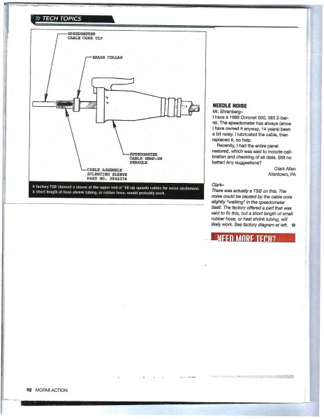

You mentioned the plastic clip is broken off the speedo cable. Could this be the problem? I saved this from a Mopar Action Tech article.
The clip is required... To keep the cable fully inserted into the speedometer.. Sometimes hard to reach up in there and snap in properly..
Just my $0.02... :thumbsup:

And I'll bet that missing clip is the issue with my speedometer. Thanks for the replies.
