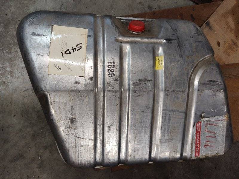

Here's the original tank
You can see the shallow curled lip. New tank:
That curled lip goes much deeper in from the seal surface.
I never even thought there could be more than one cap style, at least not before everything switched to the current plastic ones.

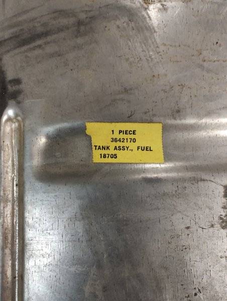

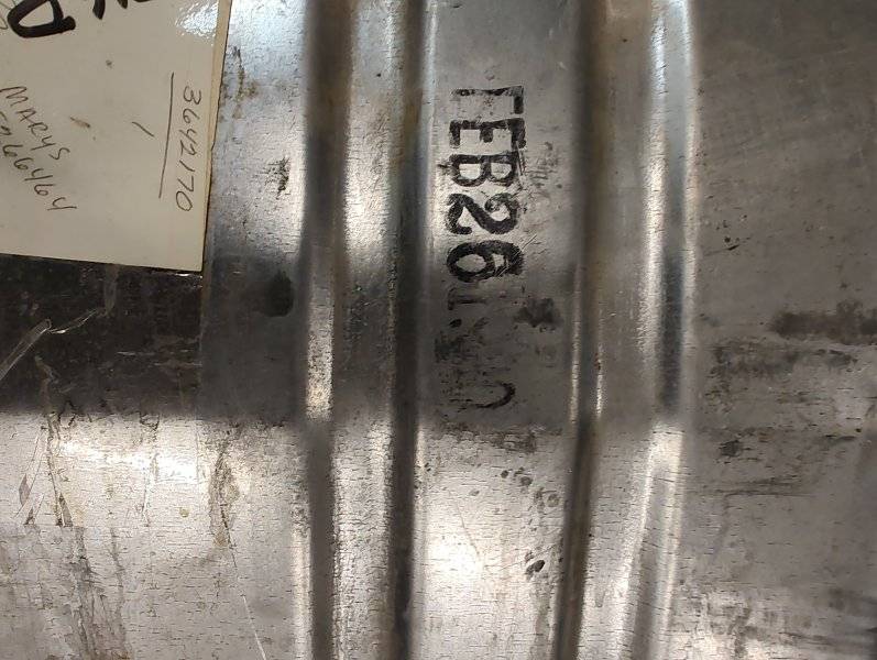

Vin and production date:
Well new cap came in at local AutoStoned. Deeper. Worried maybe too deep, but...nope. Works perfect! Tank has about 2 gal in it, no leaks yet (fingers crossed - they're a stupid damn design with a seam right down the center of the bottom), and I have it running off the tank now.

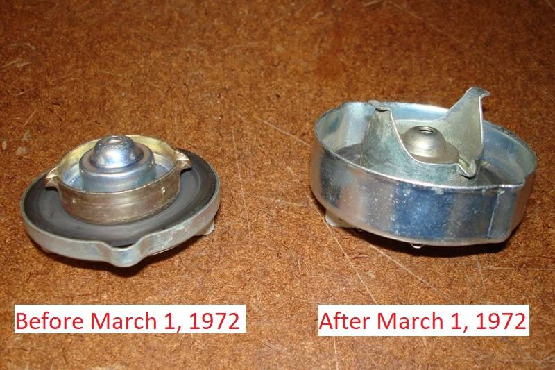

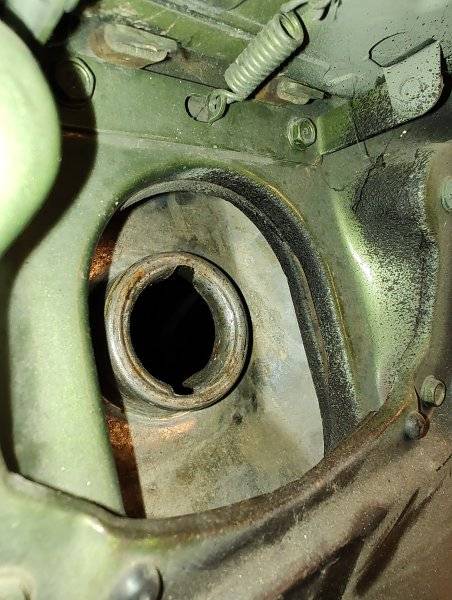

I put a new fuel tank and filler neck on my 72 Satellite. The factory fuel cap is to lose and will not tighten. After a little research, I got a factory 1971 fuel cap and it works great. It seems that the filler neck changed from 71 to 72.
Except Station Wagons, the fuel cap/filler tube change took place March 1, 1972, it was a mid-year ‘72 change.
