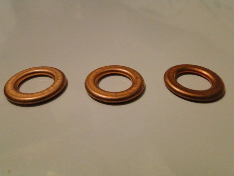

I've got an Oil Pan Drain Plug that is leaking, and was hoping one of you Mopar experts could offer me some suggestions. The car is a 70 Coronet R/T w/ a 440, and this is my first Mopar. The Oil Pan appears to be in great shape, no visible dents or damage. The Drain Plug (PN 2125890) is original, and I put a new orig Washer (PN 2268513) on the Plug. I've tightened the Plug to 25 ft. lbs, didn't want to go any tighter and strip out the Pan threads. My most recent attempt at repairs was to wrap the Plug 3 times (clockwise) around with Teflon plumbers tape. This got the leak down to approx. 1/2 a teaspoon per day, however it is still leaking. A minor issue but it's irritating the heck out of me! I've never had this issue with previous muscle cars that I owned. Any suggestions would be much appreciated? thank you, Richard

I've had friends use these copper crush gaskets instead of the orignal washers and it stopped the oil drips
They use to have oversized plugs to replace the original if you stripped the threads.
Moes, would you have the 1) diameter, 2) thickness, and 3) Parts Store? thanks, I'll try this
Moes,
Looks like I can get an assortment at almost any parts store and Harbor Freight

I'm with moes I use the copper washer as well... but I'm using a milodon pan and I tighten it pretty good, more than 20lb-ft I'm sure. Tighten it some more and see how it works... You'll have to King-Kong that thing to strip the threads. If you use a copper washer, tighten it real good, and it still leaks then it's possible there's a tiny hairline crack in that area.

Thanks for the information. I've had a problem on one of the front brake hoses leaking at the caliper on my old suburban, and I had to tighten that caliper bolt A LOT. Sounds like a similar problem. I'll also try a little more on the tighten. thanks, Richard

Thanks, the Pan surface around the threaded area doesn't look scored and appears to be flat. I'm going up to Harbor Freight to get an assortment of copper crush washers (as soon as I finish the two page list of things to do from my wife).
