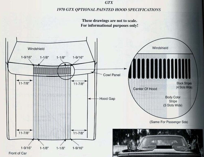

We used a gloss black and added a flattener to it. It produced a real nice semi-gloss finish. I don't think the textured Organisol is correct on the 70 RR and GTX. Here's the drawing specs...
Dave
The friend that Greg got his car from knows paint, and knows Mopars. I've got to figure if it was supposed to be it would have been. He's kinda **** that way:grin:
