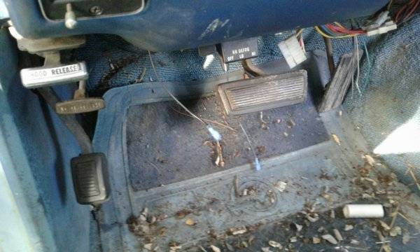

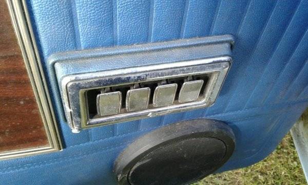

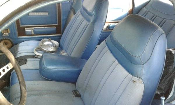

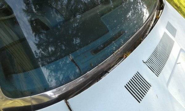

Scored some hood-mounted turn indicators, a rear window defogger setup, power window switches/wiring, 4 factory steel rims, split bench with fold-down arm rest (which I actually don't need, but someone might), AC stuff, a power brake booster/linkage... don't know if the front/rear window brightwork will interchange, but it's all pretty nice, wiper arms, extra dome light assy, e-brake pad, gas pedal setup, wiring? clips, brackets, connectors, fasteners etc.
20171014_162047_resized.jpg 20171014_162120_resized.jpg 20171014_162225_resized.jpg 20171014_162248_resized.jpg 20171014_162307_resized.jpg 20171014_162324_resized.jpg 20171014_162458_resized.jpg 20171014_162529_resized.jpg

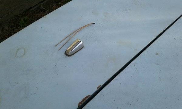

..and an RH mirror

Does the seat back tilt?
I could use that buddy seat ... if it was gold. That '72 Satty must be a Custom because it has all those options.

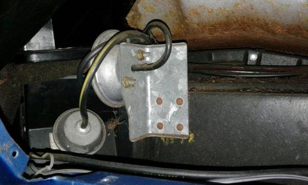

I haven't pulled the dash yet, but I finally did find time to take a couple of pics of the heater/AC box in the 72 Satty. This one appears to have vacuum actuators?... now, I'm new to restoring old Mopars, so I might be looking at the wrong thing?

Unfortunately, it does not appear to. I can double-check in the daytime where I can see better, but I don't think I missed anything.
Too bad, because it would look pretty cool in a 2-door, I think.
The 4-doors used the same seat frame as the 2-doors. Is easy to convert to a 2-door seat. Do need the release button, cable and latch which I have a couple setups if interested.
