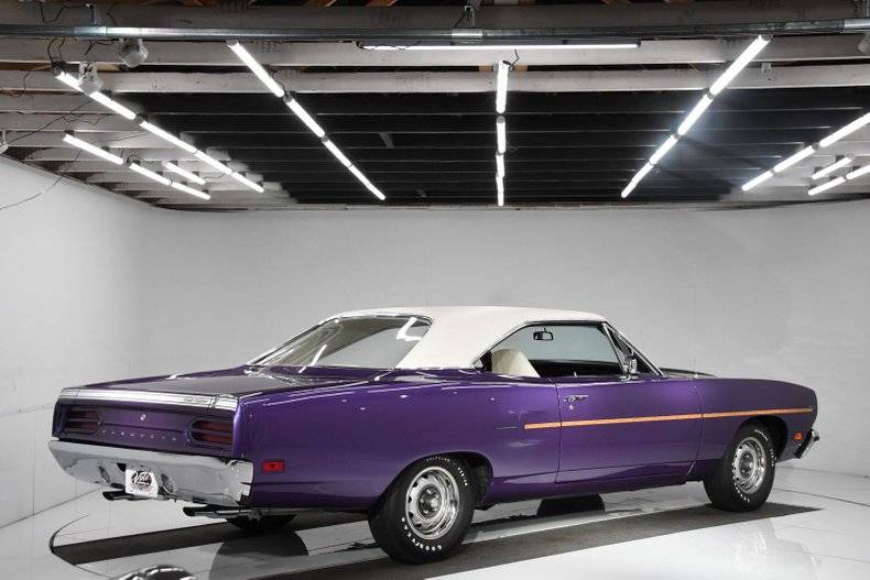

Hello! I am new here and a proud new owner of a 1970 Plymouth Roadrunner. I wanted to pick your all's brain on how you clean your cars. To give you an idea of the environment mine will be in is a oil furnace heated garage that is sealed with spray foam. No humidity in the winter and a slight bit in the summer. My concern here is rust, the car is completely restored with only one spot where it had a reese hitch at one point, small. When cleaning your all's cars, do you use water, waterless bath, or simply just wipe it done with a microfiber rag frequently? Give me your opinion with detail if you could or even share the products you use. ALSO, do you ever put a cover over your car? What brand? Thank you!
Attached is not my car, but identical

Wow I love those white vinyl tops! my 70 is coded for V1W and black interior which is odd so I go without the vinyl. I wouldn't be too concerned about washing the car if you keep it in a dry garage.
