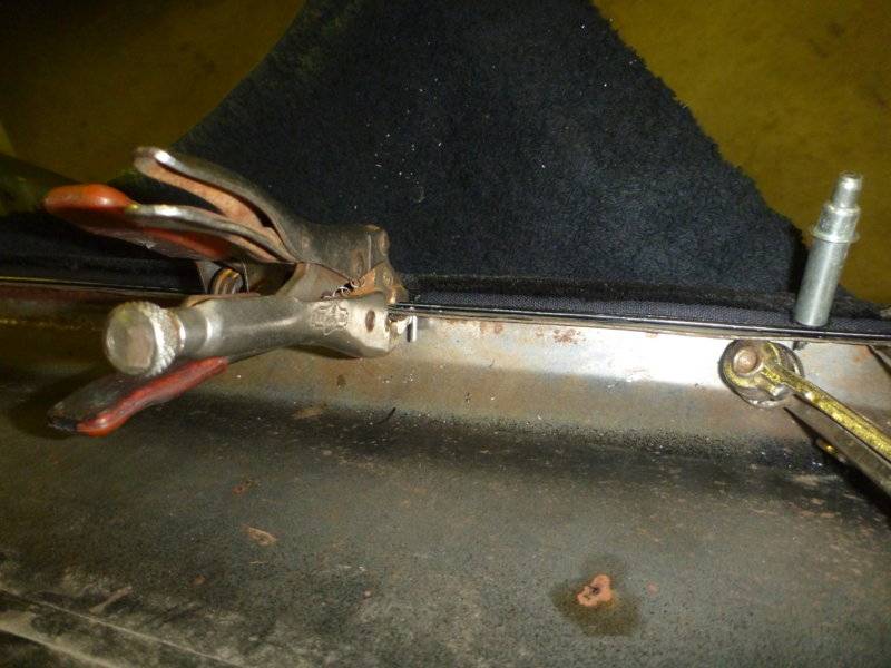

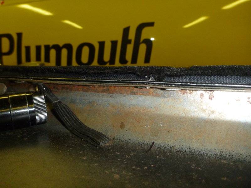

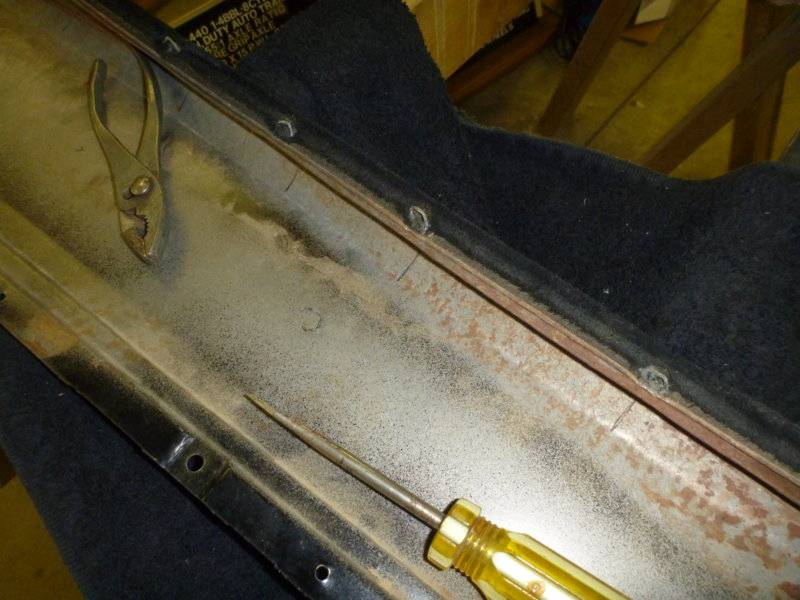

I mark approximately where the OE's were, remove the staples, clamp the new felt in place and then drill new 3/32" holes for the new staples. Clamp staple/felt tight with vice grips and I then bend the staples out vs the way the OE's went in on the back side. I've seen them drilled and riveted and screwed as Justin does as well.
