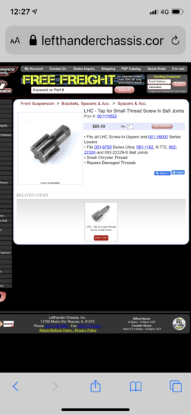

I found it only on one website LHC .
But they not respond on my mails , and I can not order from their website directly because they not shipping to Germany
Anyone knows who sell it too?
i check already summit / e bay.com / amazon.com / Jegs ... nobody have it ...

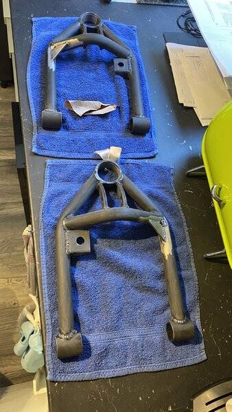

I like to have the tap . Threads are “ dirty , not get out with wire brush, ball joint material in the threads of the arm . Can also not replace the lower control arm , because is 1 generation control freak , they not produce it anymore . They already have generation 2 , but the arms in gen.2 not fit my 1. Gen chassis

This is a lower control arm from the first generation IFS Control Freak Suspension . You not can buy it anymore . Just repair it , or manufacture a copy of it .

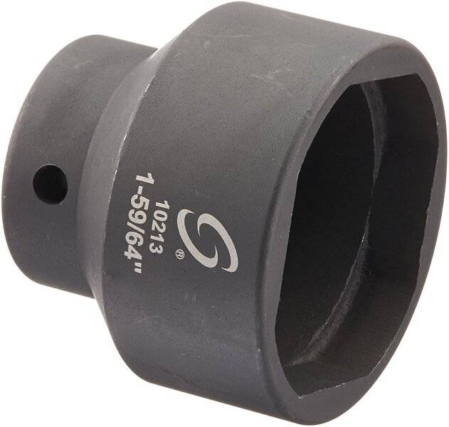

There is a special socket.
https://www.amazon.com/Sunex-10213-64-Inch-Joint-Socket/dp/B003IOEQ1O
