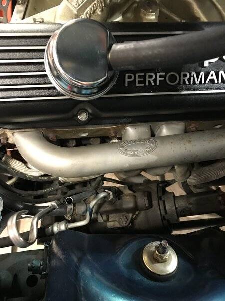

Have had hooker long tube headers on the 68 roadrunner since I put it together 20 years ago. I’ll be changing the steering box to a Bergman/Borgeson soon, so the header on the left must come out. Considering changing to shorty style, either Hedman, Sanderson, or TTI.
I’m tired of dragging the flange on speed bumps, and the Hookers have rust spots, even though they had Hookers ceramic coating when new.
OR…HP manifolds ? Engine is a 383, Hughes cam, 750 Holley vac secondary, edelbrock performer RPM, 906 heads, Mopar electronic ignition.
Like to hear some input on which one. Shortys or HP manifolds ?
Thanks much !
