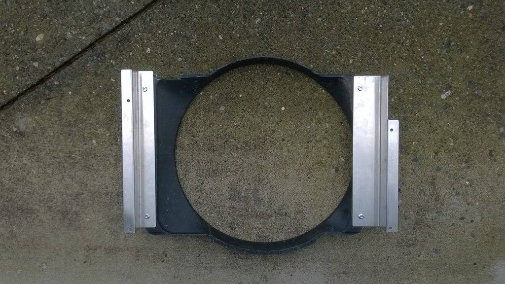

Do you have the shroud from the stock radiator? I cut mine in a couple of places, made some aluminum brackets, and attached that to my Champion rad. I do plan, however, to make some improvements with sheet aluminum I picked up from Home Depot.
By the way, Champion offers shrouds, but they are quite expensive, IMHO.

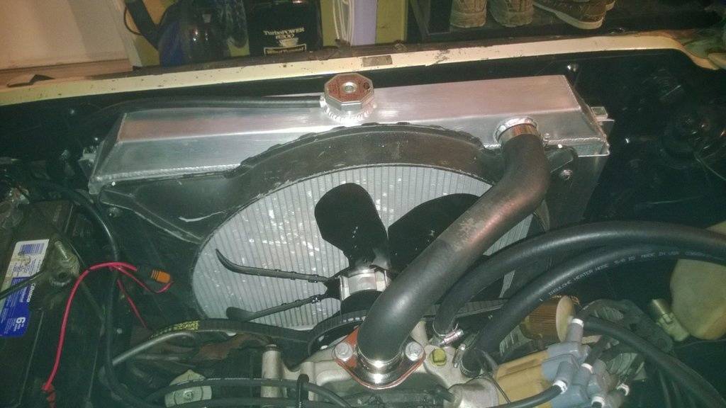

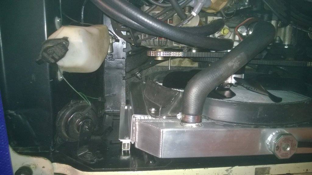

Here are some shots of mine. No idea what brand of rad but this is what I did with a stock shroud I picked up for $50. Hope it helps.
Yours looks better than mine at the moment, but more like what I pictured in my head when I add the sheet metal. :)
I believe I got real thin gauge aluminum, and had a friend with a shop bend it for me. I made templates out of cereal boxes for the exact measurements that I needed for each bend, then I rounded off the sharp corners and installed it. I looks not bad. I was concerned the plastic shroud and aluminum rad would look weird but I think its fine. You could always paint the rad black with rad paint.

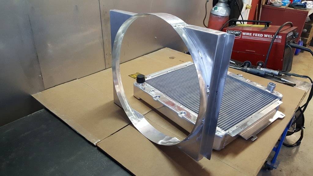

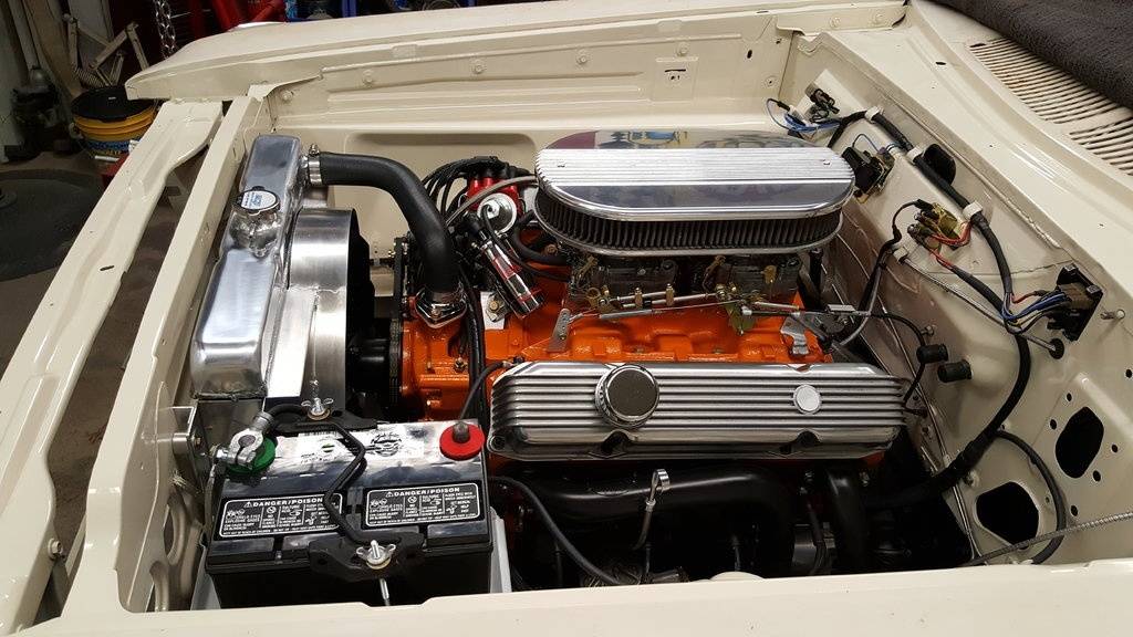

I drew up what I needed and had a local fab shop do the shroud. I got tired of trying to find something that would work.
Maybe the fab shop will do another one?
Champion emailed me back and basically said try a universal shroud, or buy a shroud from them and convert to electric fans.
That looks great. Mind me asking how much it ran you?
It cost me almost $300. It's what the aftermarket metal ones are going for, so what the heck. If I was still working where I used to, I could have made it up myself, having all the equipment to do such a job. So spend the $$$ and get past it!

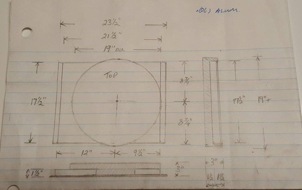

Not a Champion radiator but a Engineered Cooling Products, "ECP". Change whatever measurements to coincide with yours. Any fab shop with a heliarc welder should be able to do the job. It could be made with sheet metal instead of aluminum to save a couple bucks.
