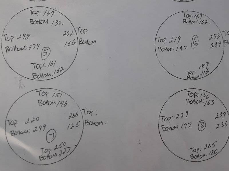

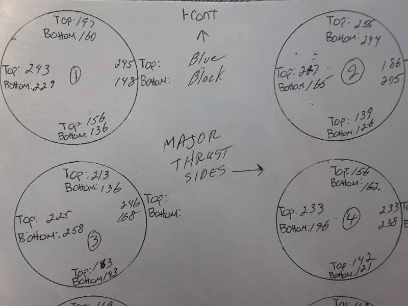

Wow! .128 is too thin, it seems. Here's the readings on the block we are going to use. #2 at .186 up top on the major thrust side is the thinnest. Should be ok, even with another .030 bore to 60 over. That Takes .015 off each side, so it would be at .171, which is the bare minimum.
View attachment 731895 View attachment 731896 Wow! .128 is too thin, it seems. Here's the readings on the block we are going to use. #2 at .186 up top on the major thrust side is the thinnest. Should be ok, even with another .030 bore to 60 over. That Takes .015 off each side, so it would be at .171, which is the bare minimum.
Thanks for posting that pic. I finally found a race shop close to me to sonic test my 400. I'll be showing them this picture of how I want my results. Thanks again.
