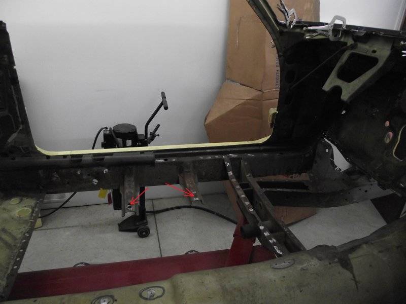

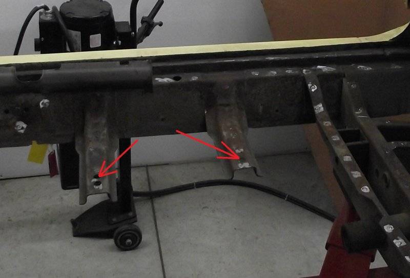

Hey if it’s a bench seat car can I get pics of the holes in the pan ( just replaced my pans and need track locations on both sides. Thanks
I have always ordered the Summit branded sound deadener and received Fatmat in a generic box for less $$$.
The holes are the outer ones in the seat supports on the underside. They are also "dimpled" on the top side of the pans.

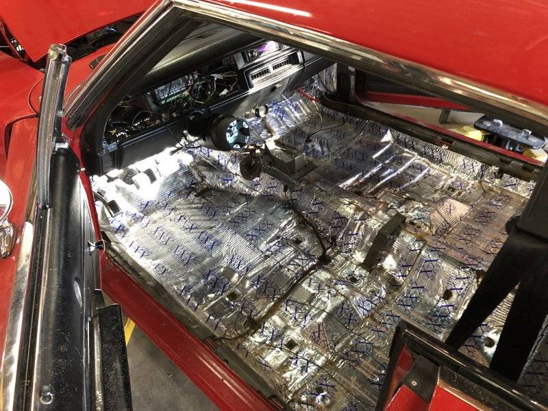

My 69 Charger would be about the same size as your 69 Satellite. The Charger’s two doors took 5 square feet each and the firewall and floor (toe pan to the rear waterfall rise at front of rear seat took 72 Sq feet.

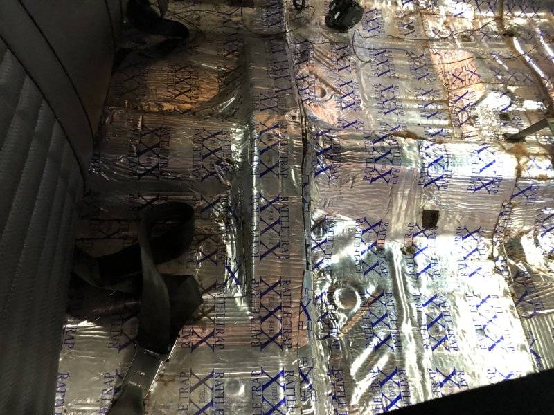

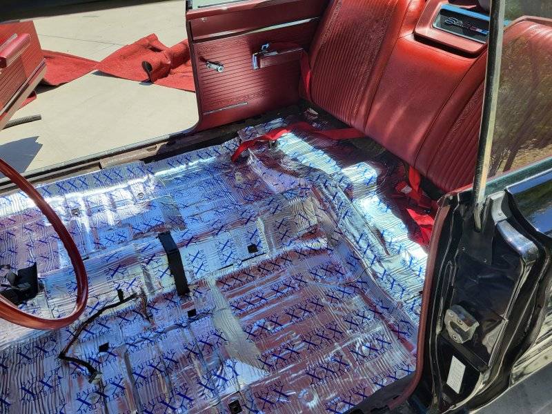

I did the floors up the firewall a bit, rocker panel to rocker panel...
I went under the rear seat bottom and stopped about where the upper section was.
The doors and quarters got some on the inside of the outer skins.

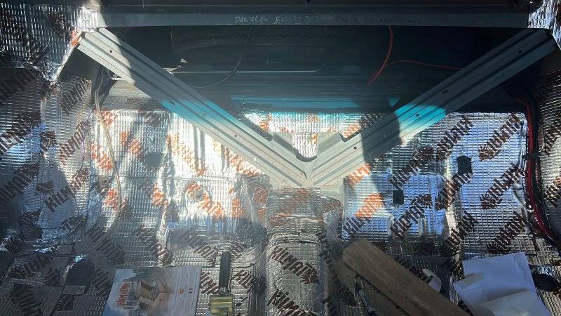

I bought a 50sq ft roll of Fatmat off ebay. Did my entire floor from lower firewall to back under the rear seat. I had enough left over I might be able to add some to the insides of the doors. But dont think I have enough to do both doors. I'll have to find the remains of the roll and ck

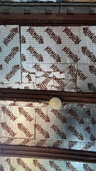

I used Kil Mat. 36 sq ft is more than enough. it's cheap. I was amazed how well it worked. Least expensive stuff I found. I'd use it again.
