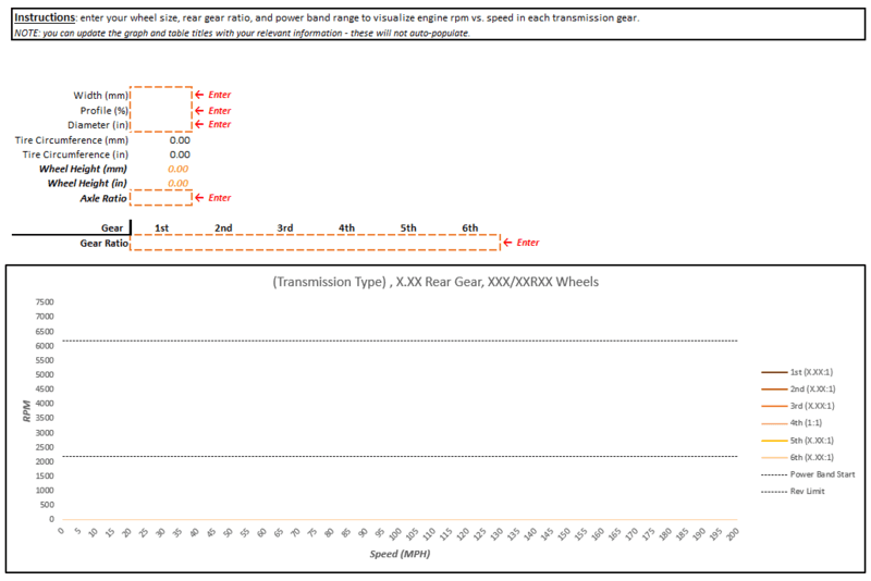

This spreadsheet is designed to provide a graphical representation of your engine rpm vs. road speed based on your transmission and rear end gearing, as well as your tire size (height), and given or desired rpm band based on your cam selection.
All you need to do is input these variables, and a table and graph will auto-populate. I find this is very useful for rear end gear selection, or even transmission swap considerations, as you can see when you will need to shift based on your cam/engine characteristics, and what the corresponding rpm drop will be.
Blank table:

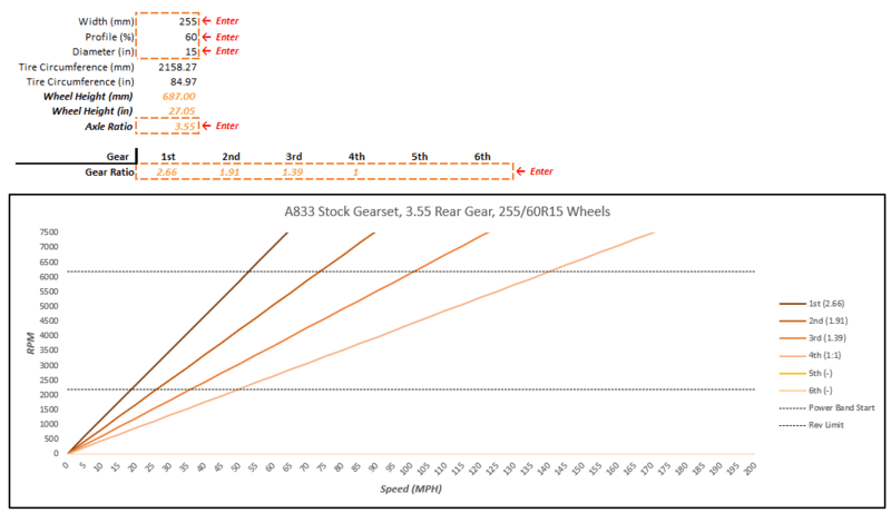

Hypothetical example from my 69 Bee:

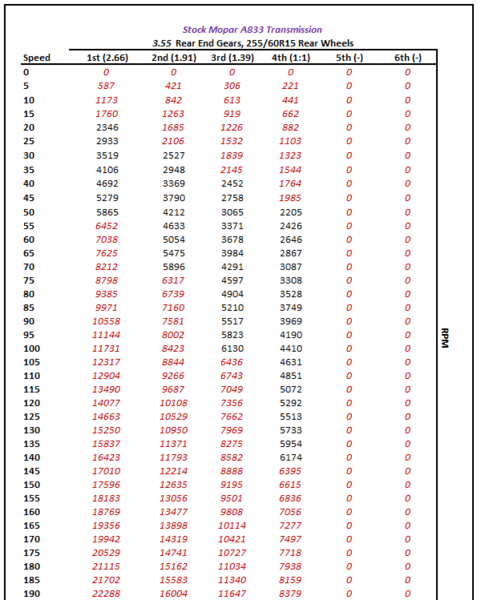

with corresponding RPM table (red indicates values above or below the selected powerband):
The file is set up for up to 6 speed transmissions, which is really helpful if you're doing something like a T56 swap.
