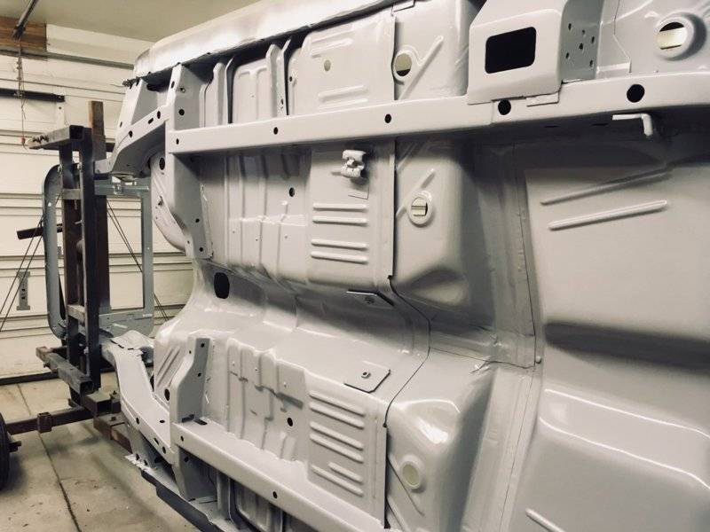

If I remember the bolts are 1/2" instead of the 3/8" factory, you just have to open them up to fit in the correct location. I wasn't real impressed with the trans mount bolting on the back of the crossmember but I think it will be fine. The templates are about useless. Not sure how you could 'squeeze' the factory crossmember together? I'm wondering how much of the cost was templates and instructions, they could have been better. This is where mine is at.

Your picture looks like what I want mine to look like in the future...only difference being I added front 'torque boxes' as well.
We put the inner holes in where they go bolted everything in place and opened up the outer ones, the trans mount has bushings in it harder to adjust it. If I was going to remake the trans mount as you suggested I would make it like the factory one and go on both sides of the original crossmember, just my opinion. Front torque boxes are there as well as the rear. I too am using a Gerst front end.
