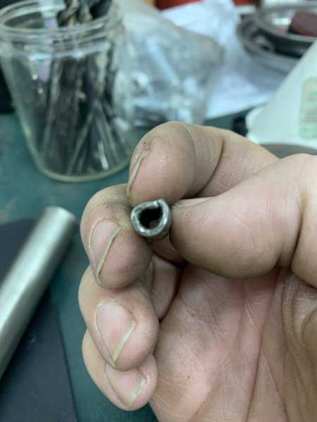

This a factory column and coupler as well as power steering gear. I am attaching a pic of the roll pin that came out during disassembly.

Picture of the roll pin isn't nearly as helpful as a picture of the coupler hole would be..
The roll pin is deformed from being driven in with this alignment issue at some point in its life.

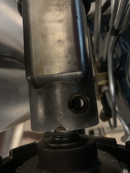

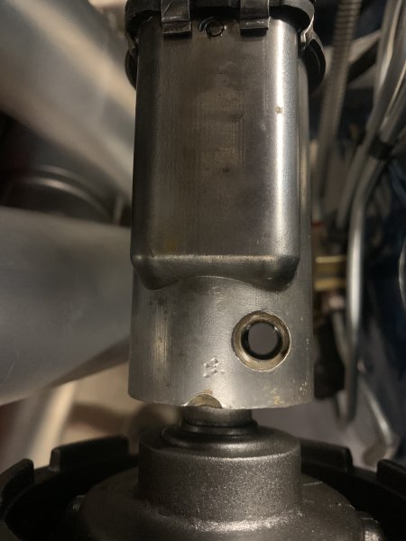

Here’s maybe a little better pic of the hole
Really isn't much you can do about it short of replacing the coupler and/or the steering box... The pin was in the hole before, it'll go back in the hole... Like gkent mentioned the groove goes all the way around so it's not an alignment of the shaft issue.. Put the pin in the hole & know it's not going to fall out..
There is no "roll pin hole" in the input shaft - just a groove around the whole thing. In the photo the hole is round all the way through so what's the issue ??? The pin serves ONE purpose - to prevent to coupler from coming off the input shaft. So the pin only has to fit snug in the coupler - doesn't even have to touch the shaft! Get a new pin !!

I’m fully aware of the groove in the shaft and how it all works. Im also not a rookie here the groove in the shaft is protruding in the hole in the coupler otherwise a 5/16 roll pin punch would drop right in. I will beat it back in there like it was and call it done.
On second thought I will cut the joint in a new roll pin wider to allow the pin to reduce in diameter a little more. doubt it will fall out at the high rpms the shaft sees.:thumbsup:
With the coupler in place you could use a small stone and a die grinder to relieve the shaft in the correct place.
