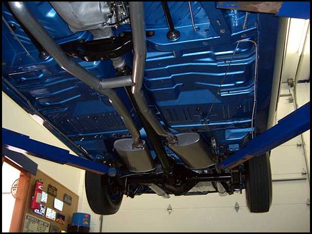

It took me a while but I found this hemi correct on Mecum and low an behold it is.............BLACK (yeah-yeah, I know its not original paint in the pic and its probably a dana 60, but this is all i could find).

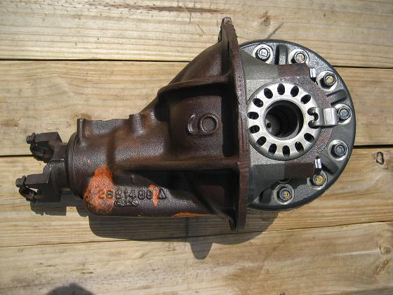

here are some 69 chunk markings, also I have seen a lot of org B bodies with a yellow B marking on the rear of the housing.
This chunk was removed from a 35,000 mile car

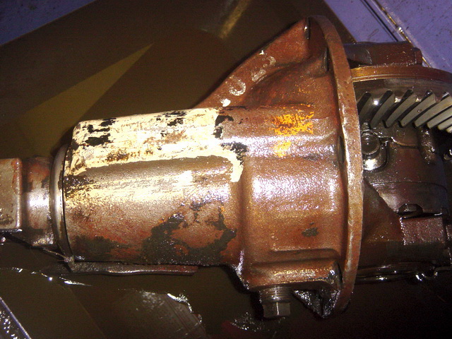

The original paint markings on my '68 3.23 SureGrip were a little different than your '69. Looking at the lower of the 2 pictures, mine was painted orange near the large flange (like yours) but painted with a white stripe along the bottom (in the area where yours is yellow).
I'm sure plants vary some as do the people doing the markings. Also 68 is a 742 and this is a 489, different sure grips and possible reason for different marks. I know a 489 with 2 yellow strips will indicate a 2 series ring and pinion and 3 strips will indicate a 3 series ring and pinion. This is a 489 case 2:76 sure grip.

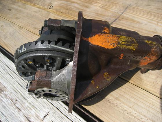

Here's a picture of the factory markings on my '68
By 68 B-body rear 8-3/4 had a large "B" painted on the rear center section. It appeared to be yellow.
Thats the B I spoke of earlier, I have seen many 68 and 69's with that marking. No pic's right now, but I'll see If I can get one of my car.

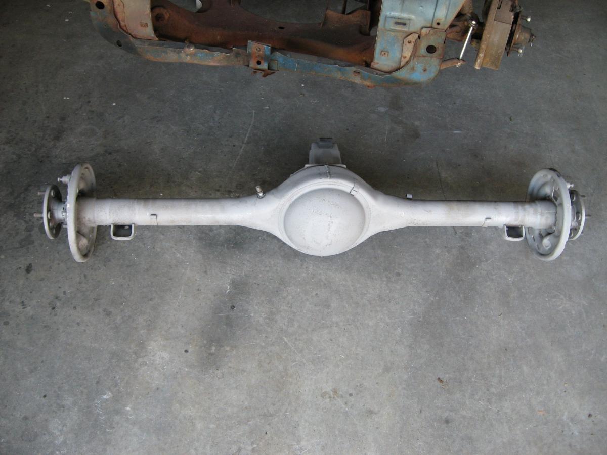

Can Anyone clear up the question of whether the backing plates are natural steel or black. I have seen them both and painted my 3rd member and backing plates with Eastwood Spray Gray. I saw a concours resto where he painted them like I did but cannot find any pics of what is what?
