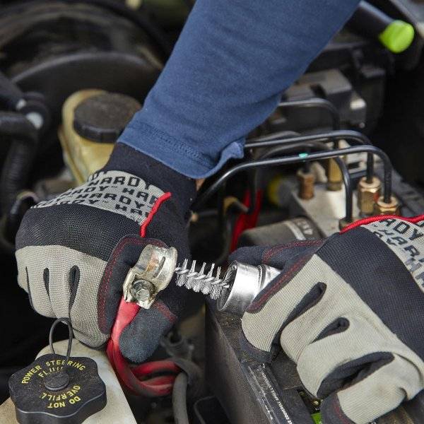

Clean your battery terminal connections. Yes it could be that simple. Or the bulkhead and connections at the starter relay.
Lastly don’t overlook a bad battery cable end,where it is put together, they can look fine but won’t be able to supply 250 amps to the starter.

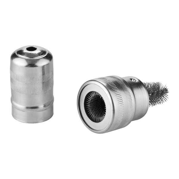

Battery Terminal Cleaner
