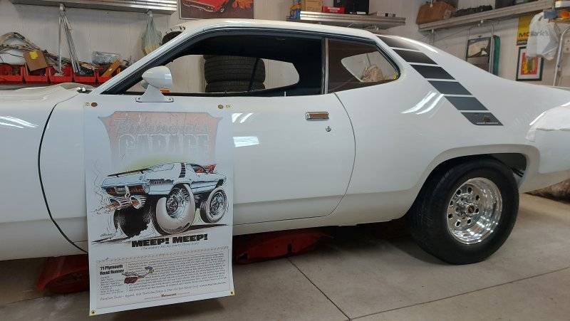

Here's a 275-60R 15 on my Runner.
More than enough room for a 295-60.
