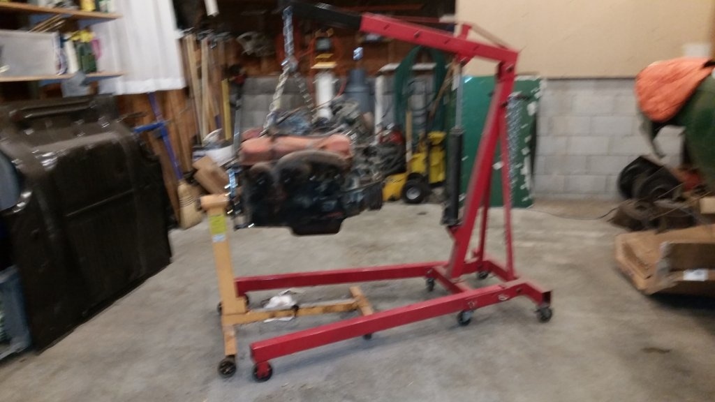

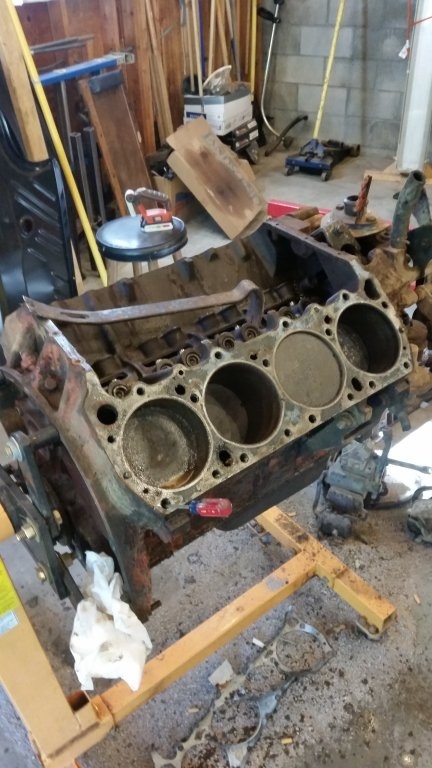

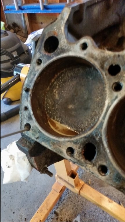

couldn't wait any longer so I broke down the 440 to see what I was dealing with after it sat for decades.

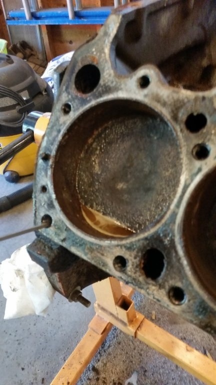

2 cylinders have some water damage / rust. I believe this is the reason that its stuck
Any tips on breaking down a stuck engine? good penetrating solvent to soak the cylinders?
Will I have to carve the piston out with a die grinder?

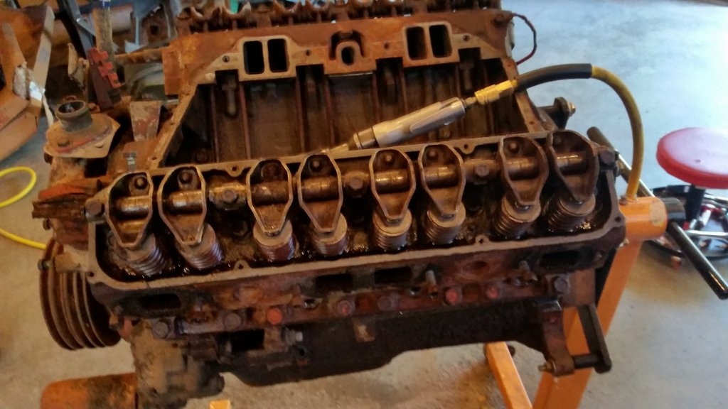

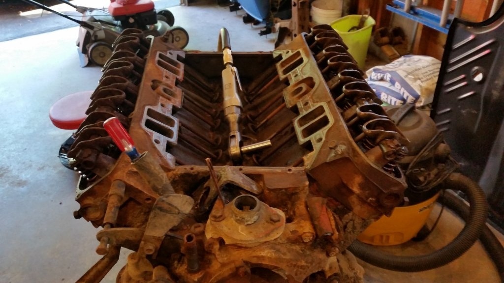

I appreciate all the tips! So I wanted to get this engine apart to start the unsticking process. I didn't know what I would find and wanted to find out and get the process moving! So for now, I've torn the engine down except for the short block. Got all the lifers loose, cleaned the sludge out of the oil pan, dealt with the broken nuts in the exhaust manifolds, and the one rod bearing cap I took off shows that the lower end and crank is fine. Soaked cylinders several times, dug around the top of the pistons with a razor knife, soaked it some more, and reassembled it so as to not loose track of parts. Now its a waiting game. Now I can try all the potions! I like the ATF and acetone idea for some reason.

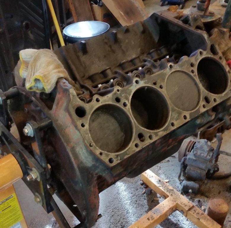

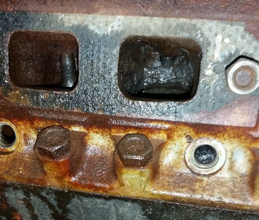

Hrmm, whats missing here?

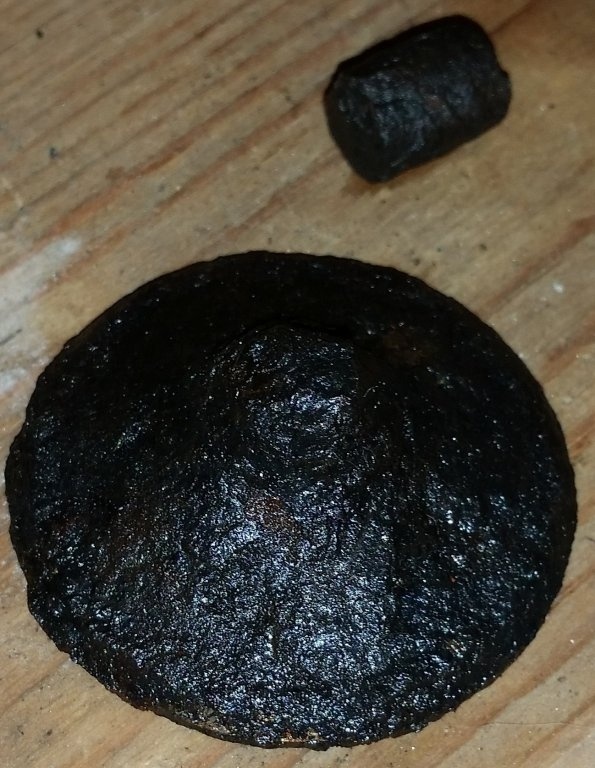

Here is what is missing! It's an exhaust valve! It's the only dropped valve I have seen that dropped when the engine wasn't running, ...me lucky
The valve corroded away......had strange levels of corrosion on the exhaust ports that were hard of the heat riser...early evap ports.

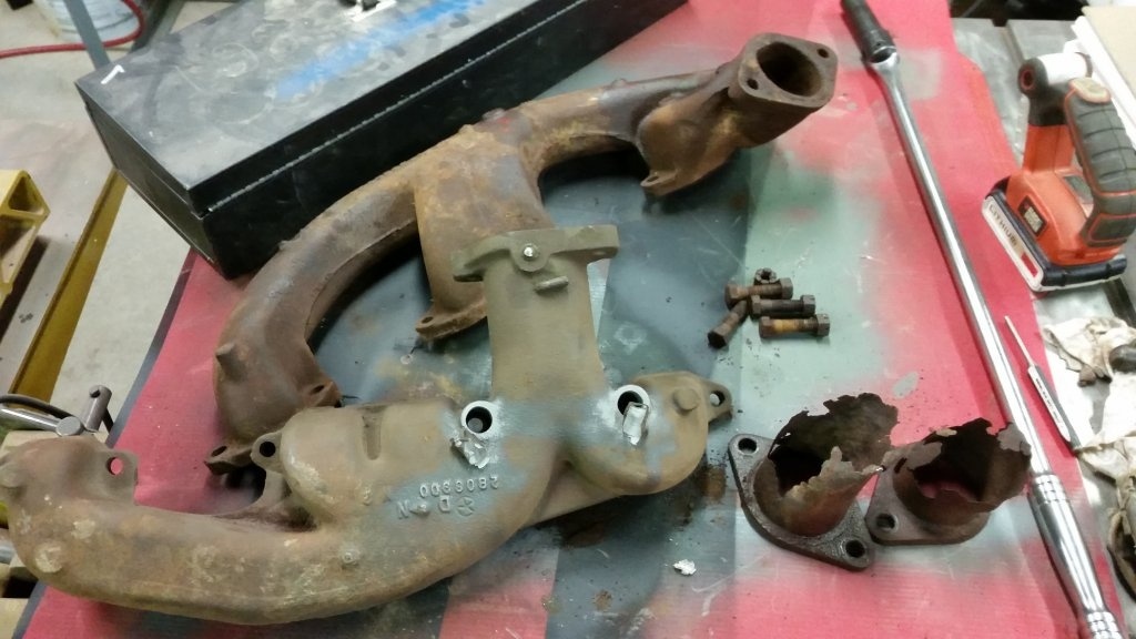

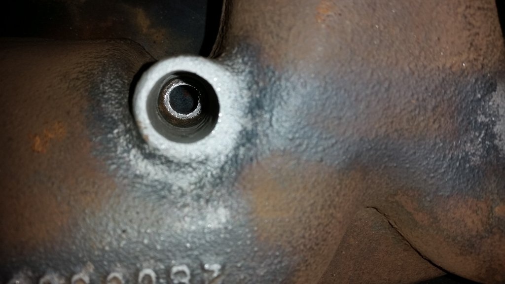

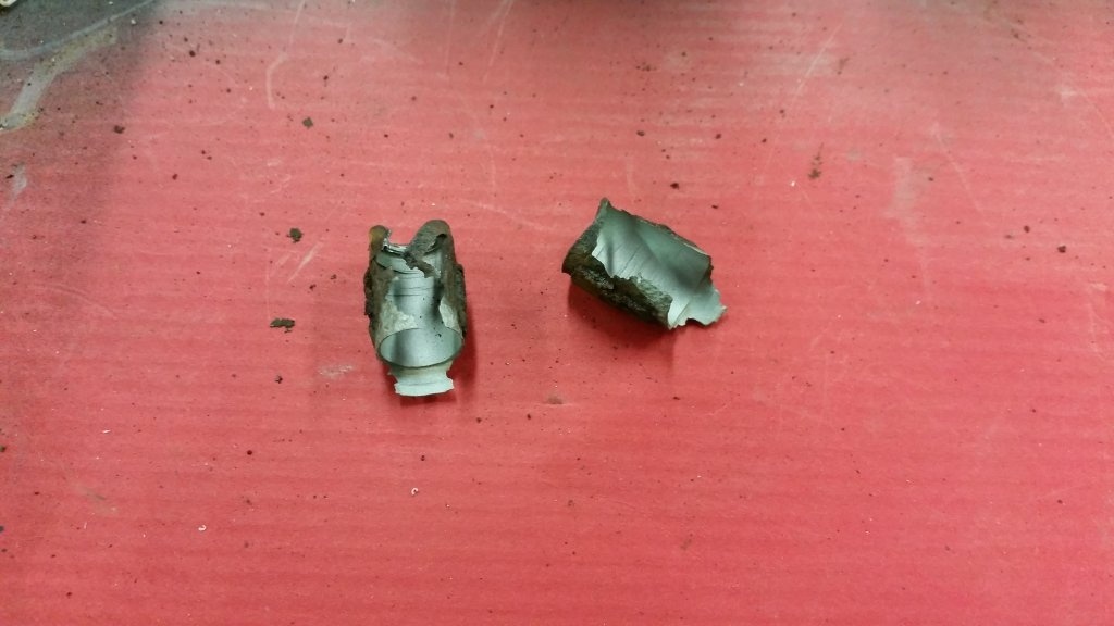

Fun Fun Fun drilling out the broken exhaust manifold nuts. Here is what remained after I extracted the remaining nuggets from the manifold!

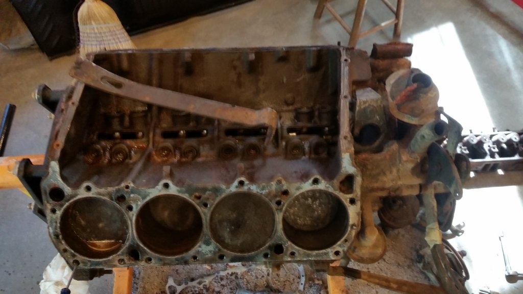

Back together loosely waiting for magic penetrating oil potions!

Just a recommendation, I would turn the motor 90 deg where the piston are facing straight up, that will ensure that which ever penetrant you use gets to all sides of the of the piston.
The rings are what is rusted to the cylinder wall and needing to soak. Flip it and do the other side in a day or two...
Typically the rust is mostly on the top side of the piston, I'd pull the crank and drive them out the bottom. I'd also never drive them out by the rod even with a wooden block... beat on the part that will be getting tossed.... the pistons.
