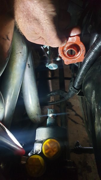

How did you get the seal for the coupler over the dowels on the steering shaft? Will it tear the seal if I try to wedge it over with a screwdriver? Is the seal in the photo the correct position to slip onto the shaft?
