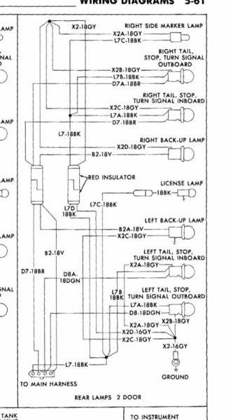

On the ’72, the tail light harnesses are not being reproduced. Originally serviced as part of the tail light housings, sockets and connectors are sealed. By “new harness” I assume you mean the body harness from the driver’s kick panel to the rear bumper. The correct 1157 bulb should only key in one way, the low watt filaments should be all wired to the park circuit. The park circuit is the only circuit connected to all four tail light bulbs, license plate lamp, and the right side marker. The, two per side, left and right high watt turn signal/stop light filaments are wired separately. A single reversed connection somewhere is not likely. Either the wrong bulbs or the tail light harnesses have been rebuilt/rewired incorrectly.
At the body harness connector;
Grey - ground
Black - park lights
Dark Green – left turn/stop
Brown - right turn/stop
