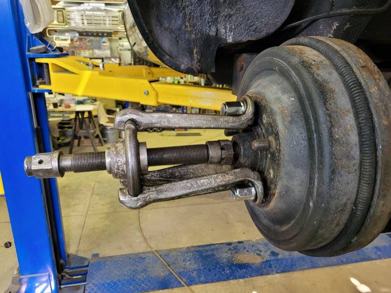

I'd see if they just come off before buying the tool. I had one drum I simply slid off and the other came off so easy I doubt I needed the puller. I picked up this oldie for a 100 bucks CDN shipped, off of Facebook Marketplace..
I bought one years ago just like Dad. It wasn't off of ebay though.

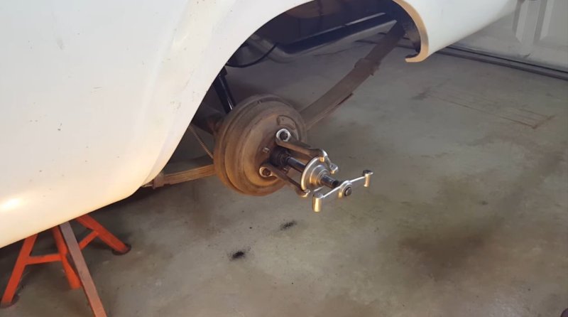

They're on Amazon new. From $53 on up. Different brand names, just read the reviews. TruePower had some good reviews.

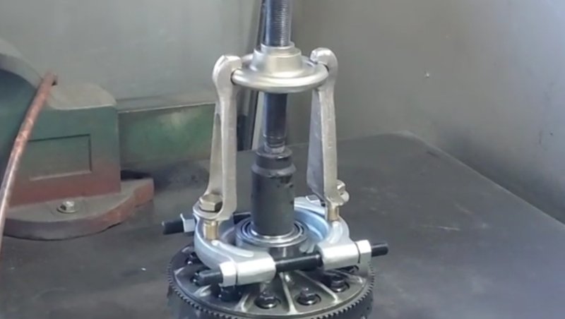

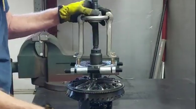

I believe I bought mine on ebay, new and I've found other uses for it, not just drum removal. Easy to adapt a clam shell bearing puller to get at those tight clearance carrier bearings.

Those are the ones I've been looking at ( ebay-Amazon). Just want to buy a tool that will do the job, and not spend bunch of money for a seldom used tool. I knew I'd hear from you khryslerkid
