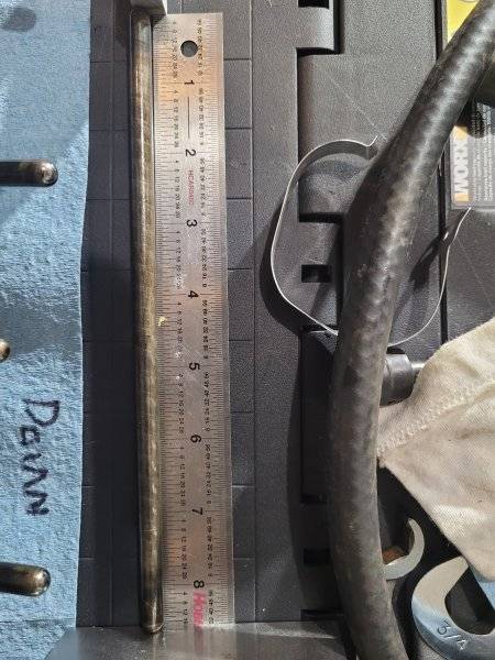

Mystery Identified. I have a bent pushrod on Cylinder 6 intake valve. I would expect when i installed i did not get the rod seated in the Lifter and maybe had it on the rim. Then on the first rotation when the cam lifted there wasn't enough room so it bent the rod. Please share any other possible causes so I know what to try NOT to do next time.
I did identify a pushrod that I can get by Saturday. I verified dimensions as 8.575 x 5/16". Please confirm I can just replace the rod. I really only need it short term due to some other work I plan to do. So if long term its suggested to replace Lifter and Rod I can do that too. Or is there more?
I did confirm I had the Rocker in correctly for oil lubrication and that all rockers had a nice pool of oil on them and all parts were well coated with oil.
Thanks for any suggestions and the help so far,
Martin

The offending p'rod probably got jammed when you re-assembled the rocker gear. I would just replace it.
Here is a trick to position the prods for assy of the shaft/rockers. Lay a piece of welding wire or straightened out coat hanger against the rocker pedestals. Lay prods against the wire; check with a torch that all the prods are seated in the prod cups in the lifters. Make sure the prod tip enters the seat on the rocker.

Glad you found it :) and by lash, i meant play in the rocker like from a bent pushrod :)
