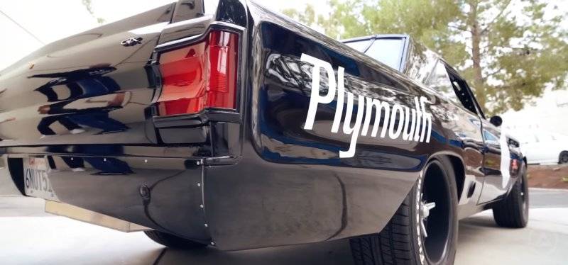

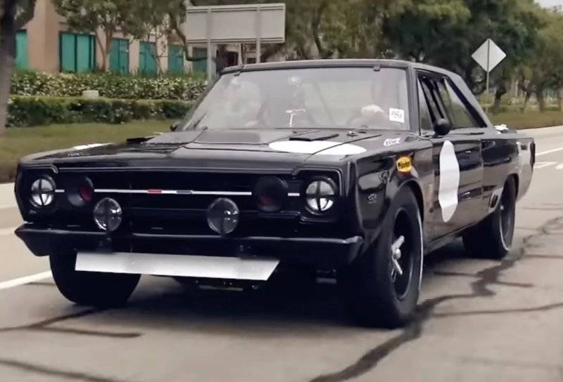

I made a short clip of the full video where he describes the front and rear fender widening. The Coronet has "hips" built into the rear quarters vs the Satellite or Belvedere, but the bowed fenders on the Plymouth look great, IMO.

This is not the car dvw is talking about though, is it?
For me, this is a little too much. It's cool, but I like the stock lines of the 66 and 67, although I did the baseball bat stretch of the rear wheel lips on mine to fit a 275/60/15 drag radial, but that was much less pronounced than this one. And mine was a rusty car anyway.

One reply was about the appearance of the 66 and 67 Belvedere Coronet and similar B-body style, and the shape, so I thought the fender widening front and rear was pertinent.
I like the overall work done on the "saloon racer" style car I posted, but that isn't "my thing" either, I was emphasizing the fender widening.
I see you "made room" for 275/60/15 drag radials, and I know if I had taller sidewalls I may run into clearance problems in the top of the wheelwell arch, but I like the looks of and have found the overall performance, especially wet surface traction/safety, longevity, and improved dry traction vs BFG T/A very good of my 315/35/17 Toyo Proxes TQ drag radials. It seems like there is significantly more room in the 70 Roadrunner rear wheelwells than the 66/67 B-bodies.

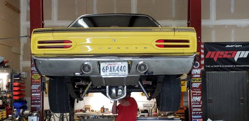

I see you "made room" for 275/60/15 drag radials, and I know if I had taller sidewalls I may run into clearance problems in the top of the wheelwell arch, but I like the looks of and have found the overall performance, especially wet surface traction/safety, longevity, and improved dry traction vs BFG T/A very good of my 315/35/17 Toyo Proxes TQ drag radials. It seems like there is significantly more room in the 70 Roadrunner rear wheelwells than the 66/67 B-bodies.View attachment 1480374
Yes sir, definitely more tire room in those 70 models. And still great looking cars.

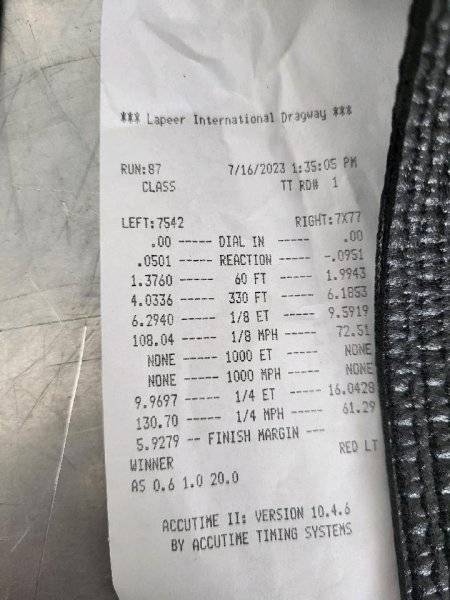

Back on the rails. Dave tested today at LIR. Turned out it only had 18 degrees total. With 35 degrees it'a a different animal. The weather today was worse as well.

I'm surprised at the low 1/4 mph. I think there's more to be had based on the 108 1/8 mph. Going to test tommorow.

I dunno. At one point my race car ran pretty close to the same numbers. Example run; 1.384 60 foot, 9.975 et, 6.334 1/8, 131.61 mph and 107.94 1/8 mph. Could be my car was not optimized either.
Glad to see it picked up a bunch. I thought 10.40s was weak. Nice that it was an easy find. I bet there's more in it still.
Race gas, pump gas, or what?
Edit: that's a NICE 60 ft, for a 3000+ car on a nine inch tire.
