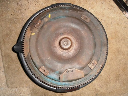

440 cast crank torque convertor needs one of these----------the weight. And yes you can see thru the inspection cover.

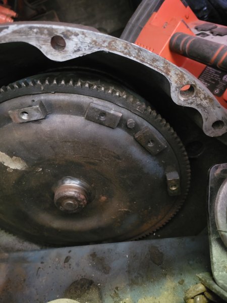

Here's is my report.
1. The 2 trans nuts were loose and tightening them made the vibration worse
2. There is no weight on my TC so those who put this machine together didn't know better
3. While it is very fast I do not intend to race it. Please offer suggestions on the new TC and trans rebuild tips
Thanks!

Thank you! I believe this is my problem. The TC has no weight. It is a cast crank motor.
