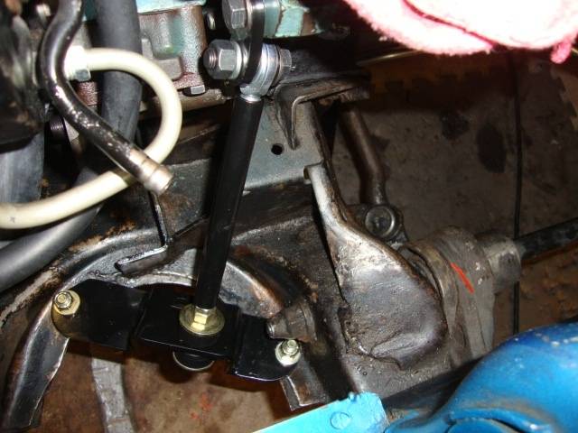

Here's one I just whipped up to keep my 451 in check. It's in a 69 belvedere so no idea if it'd work for ya...
I was planning to pull it out when school starts in a week or two and turn down the threads on the lathe at school / paint it black... but who knows, maybe I'll leave it gold.
Cost me $15 - grade 8 rod, female rod end and some hardware / bushings I had laying around.

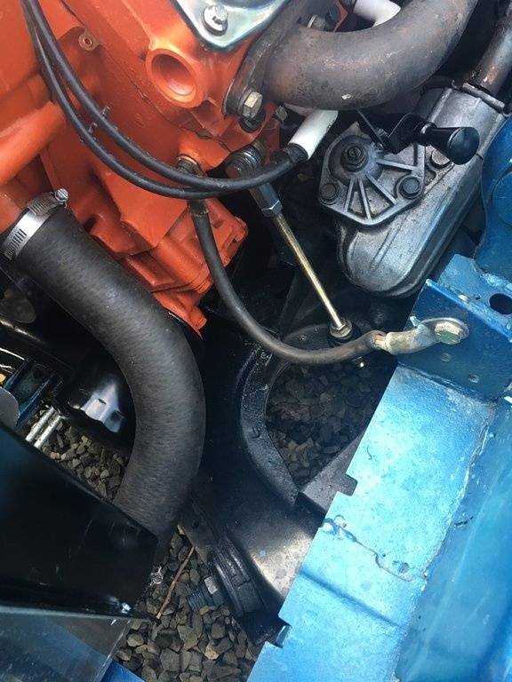

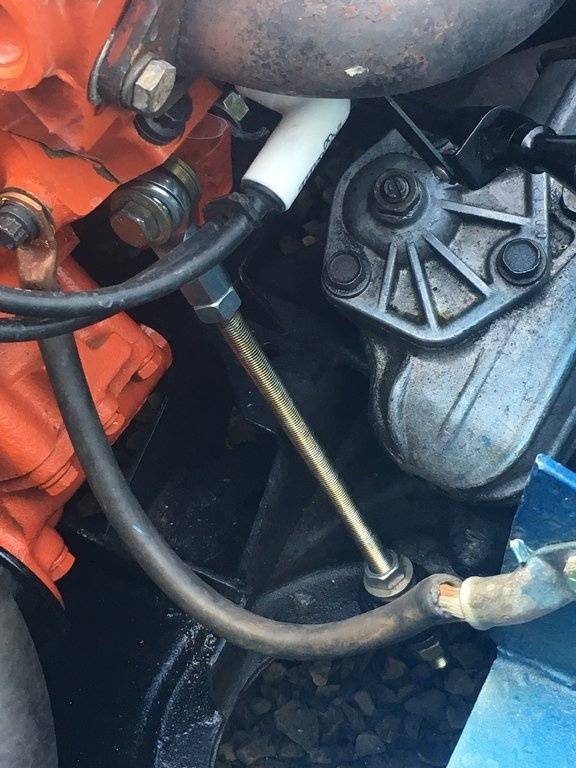

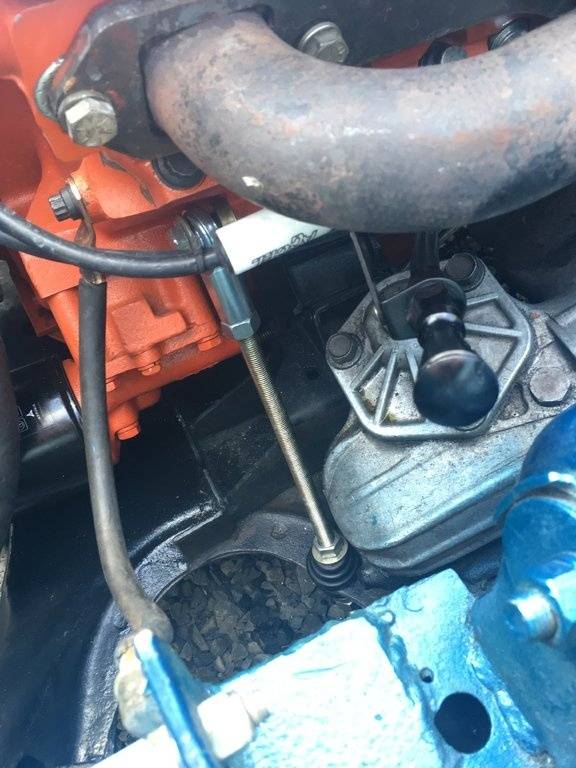

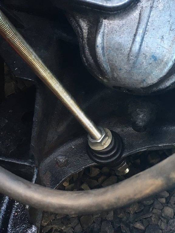

What am I missing here? ’73 with spool mounts, why would a torque strap be needed?
From what I understand, the torque strap doesn't only prevent motor mount breakage, but also breaking the mounting ears cast into the block.
Thats why I need one...drivers side engine mount ear is broken off.
Ouch. Yeah I'd look into making a torque strap asap, before you break another off. Unfortunately for us 73+ owners, handmade is the only option.
I dunno, guys, typically the torque straps are mounted to the drivers side ear - the big one to the front of the block. The good news is I've seen some mount one to one or more of the water pump bolts.
