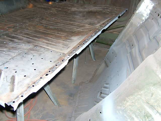

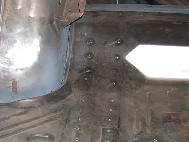

Here is a shot:
Still need to clean the frame rails up a bit and then get the old floor's flange off the whell wells...

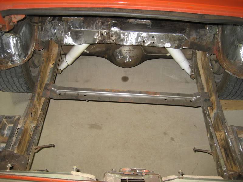

if that much of the floor is gone, if it was me, do it right and do the whole thing.
trust me, it will be alot easier to fight to get in there
then trying to splice or make a splice look nice exspecially if your a novice.
just take your time.
where you are doing it will slap ya in the face when you look in the trunk.
you are not that many spot welds away already.

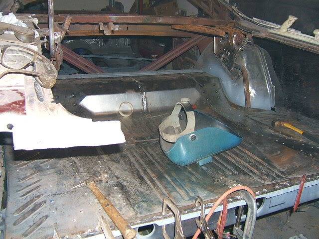

i had taken the whole tail panel off as it needed to be replaced anyway.
so i totally removed them.
then from the old floor i stole the rear flange and spliced it onto the new floor going in.
i had a 2 piece also but i spliced the whole thing together before i installed it.
if you are not needing to remove the rear panel i would splice it in just before the end x member is before where you see the clamps holding it in the last pic and i would remove the braces off the floor side and try to snake below them,you could pry them up enough to do it and then beat them back down into shape.
its a good place to splice as it gets covered up by seam sealer anyway and you will never see it or know its there
the part i added on to the floor is the primed edge you see
the hardest part of the whole thing was getting the splice down the middle good enough to make me happy. thats why i told you to try to do as least amount of splicing that you need to. its a pita to get a splice to look good when you can't hide it behind seam sealer and alot easier to drill out the old stuff then it is to splice.

I think this lower pic is the answer to your forward seam access. The back seat comes out pretty easily which would then give you access to that area.
Yeah, I've known I could pull the back seat and have better access to the area if I wanted to...
I was always hesitant to that bc the car is complete, lol...This is all it lacks...It almost seems like I'd have to pull the seats (front and rear), carpet, panels, everything to keep it from falling victim to the rust dust, lol...
I suppose I could spend some more time in the neck breaking position and try to clean everything off prior to pulling that, then just use the front access to do spotwelds etc...I just know that when I pull the rear seat there will be stuff I want cleaned and painted, I can't stand to leave stuff like that untouched, lol...
I'll see how things go this weekend...
