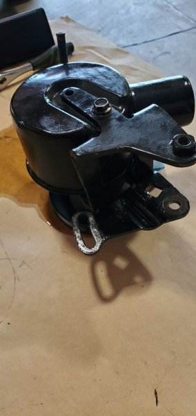

My power steering pump went out on my 67 Charger with a 440. The pump is the larger TRW pump. I can't find a rebuilt pump anywhere or a rebuild kit. I don't care about switching to Saginaw or Federal pump, but I don't know what brackets to buy. I purchased a Federal pump, but the TRW bracket doesn't fit. Any suggestions?
Find a Federal bracket. Sometimes on eBay or other. Place a "WANTED" add here for one. The Federal pump is the better one.
A place named "Hoffmans has repro brackets for different pumps. Somebody is reproducing the federal pump bracket for a BB, but I cannot seem to remember who.
powersteering.com, out of Missouri. He can rebuild them. or;
I ended up upgrading mine to a Saginaw, get a kit with the correct pulley and brackets and it's pretty simple. Found it on Ebay.
I should have a Seal kit if your interested, PM me
Thanks for your suggestions. I purchased Federal brackets through Classic Industries. I hope they fit. I haven't received them yet. I recently purchased a heater core from them and it leaked like a sieve. Had to return it.
