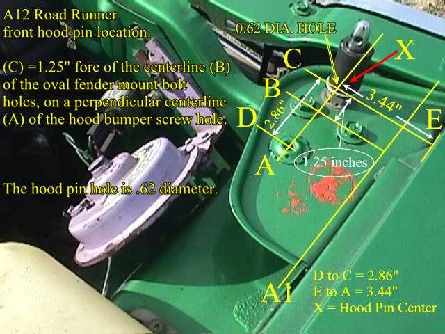

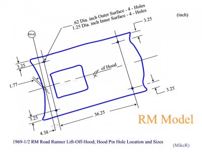

Where do the Pins mount? replace the bump stops? also where do the lanyards mount to on the radiator support? Pics?

Lanyards don't mount to the radiator support, they mount to the hood. They go to the inboard rivet, so at 3 o'clock on the passenger side, 9 o'clock on the driver's side.

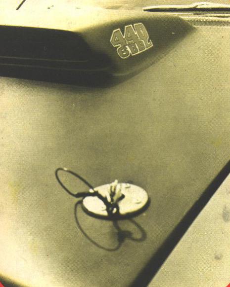

Well that's a photo of an original setup and that's how the A12s mounted the lanyards.
If you don't care about originality you could mount them down to the rad support like on a hinged hood, but you'd have nowhere like that to mount the lanyard at the firewall end of things. If it's not a lift off hood then that doesn't matter.

^ I reckon he liked the looks of the lift-off six-pack hood but wanted to keep the hood he had? But if he was going for half of the 4-pin look, the correct placement for the front pins would have been about 3" from the front edge and 1" in from each side. The ones in the pic are basically reversed from what they should be.
A12 lanyards
Mine are like 20" long not short like in the pic.
The correct 69 A12 lanyards are 6" long, coated in black and attach to the pin bezel rivit as described above.
Little known fact....... The lanyards are the same part as used to support A-body glove box doors.... part #2927281
