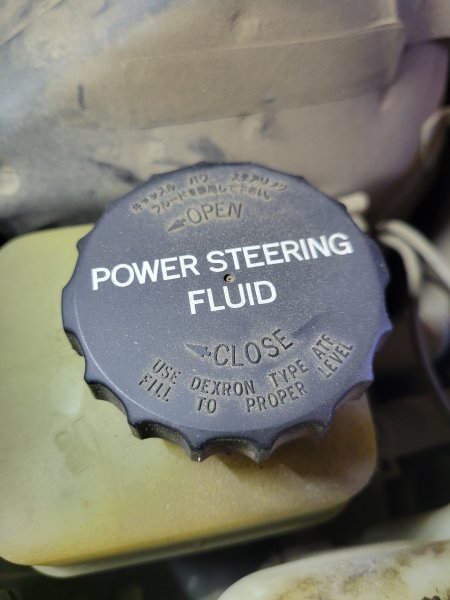

On a completely unrelated note; all Toyotas, Nissan, Mazdas, ford's, newer chryslers( not gms) use ATF for a power steering fluid.
Excuding possibly some special models.
Honda requires a special fluid
Vw requires a special fluid.
Carry on .. :lol:
Carry on .. :lol:
That's not unrelated....That's exactly what I'm talking about....2 options..ATF or Power steering fluid...Which one is correct ?? Which one is better ??
Power steering fluid......................
Universal psf was designed by gm.
If the stuff in post 18 works in chryslers( new ones by the way) then it's a replacement for +4. Basically it's all the same ****. With or without red dye.
These guys don't even care what kind of dexron type it is lol
But anyways , pour in whatever you'd like!
