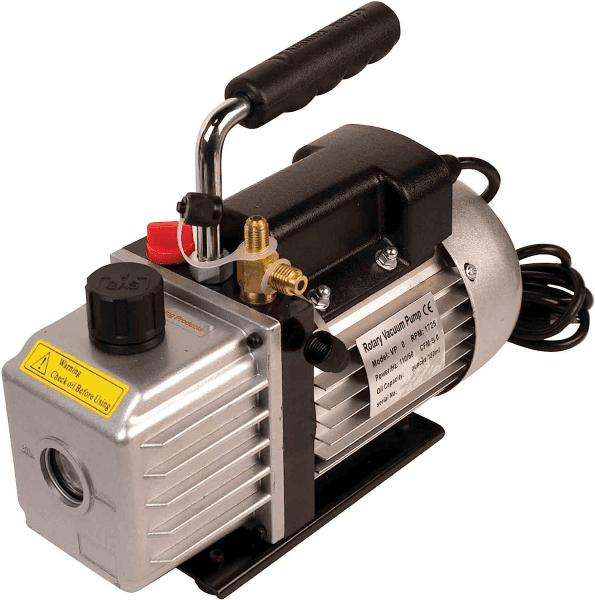

I bought a vacuum pump like this one, back before Covid off Amazon. Less then $200 and money well spent. The A/C systems I've serviced with it are still running strong.
Amazon ProductID B000XQ2S4M
