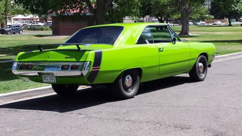

Hey Guys. I currently have an aftermarket Go Wing on my 72 Plymouth. The factory wing is thinner and less bulky and I think it looks better.
Does anyone know if the factory wing will fit on the aftermarket pedestals?
Are the mounting holes on the trunk in the same locations on both?
Are the 71/72 Plymouth Go Wings the same as on the Dodges?
No needed comments to go without a wing. I agree but it's already done.
Thanks.
Are you talking about the fatter 70 Go wing or the cool 71 Gull wing? Kind of looks like you have the 70 Go wing in you pic. No wings in 72. The wings are the same for all cars. Underside backets aren't.
Here is the 71 Gull wing.
Yes. I believe I have the aftermarket Go Wing. Definitely fatter. I assume the B body brackets are the same but A & E are different.
