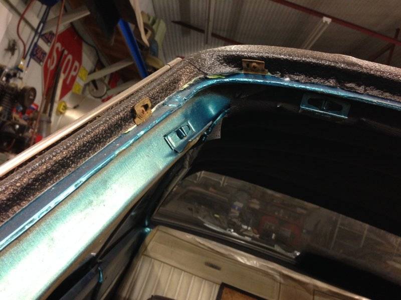

There are 8 taller clips across the bottom. Then the remaining are all the same. 3 up each side and 8 across the top. If your package has 2 slightly similar but different from the uppers, I would think they are not needed. Some kits and vehicles have 2 up in the outer corners to help with the bright work. I disassembled my car myself, so I know these are correct for my application.
Lower clips.........
Upper and sides............
Depending upon who supplied your kit, the A-Pillar used two per side of the shorter length clips. The longer ones go on the body for the cowl and the next larger size goes across the top with the intermediates on the A-Pillar for the front glass. That is what I have found to be the most popular through the years for that year model.
