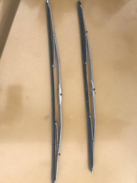

I guess back in the day before we became such a throw away society, you would just replace the rubber part of the wiper blade not frame and all. These frames I assume are the original on my 77 Cordoba. I tried putting on the standard replacement frame/blade sets on and they fit except are too tall and hit the hood. I have been digging for the old wiper “refills“ and see some stuff on amazon but not sure if they will fit. Anyone have experience with this and can point me in the right direction before I try to learn by denial and error? Thanks!

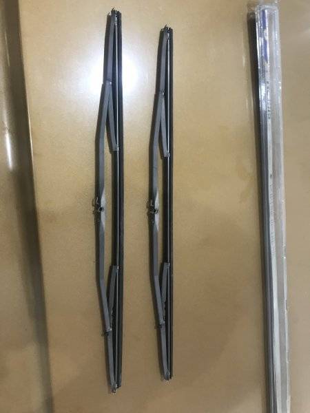

Trico classic from O'Reilly. Just slip the blade out of the new ones and into your originals. That's what I did on my 68. Might be the same for you.
Napa was a winner. Just went in and test fit parts til we found a fit. I believe the width ended up showing as 8mm. Length isn’t an issue because you can trim away the excess. Napa part number shown in picture. Thanks all who replied and maybe this will be useful to someone else.
Just got a pair from Oreilly today. Trico Classic 33-150 about $20 each. Look original and fit good. FYI 33-150 are 15"
