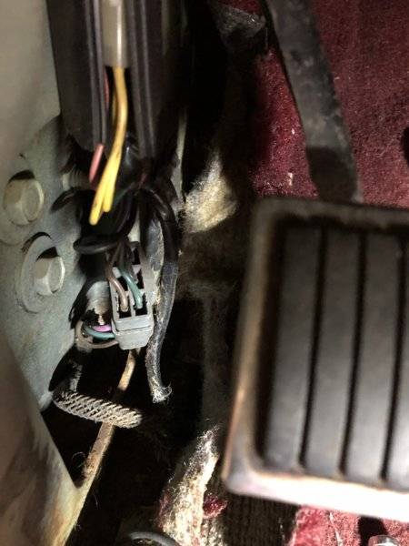

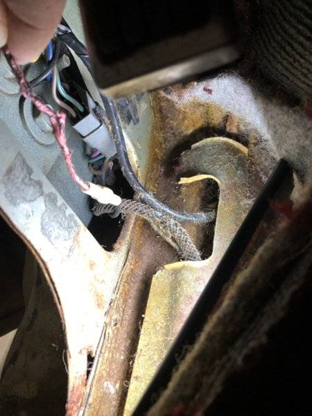

Ok so right now I have a lot of issues. My guages are not working nor my rear lights. My headlights are operational. All my fuses are intact.

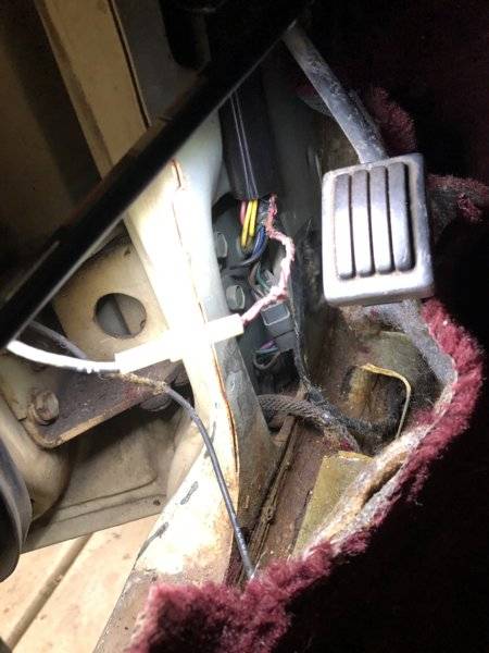

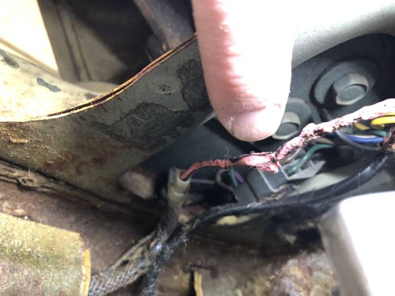

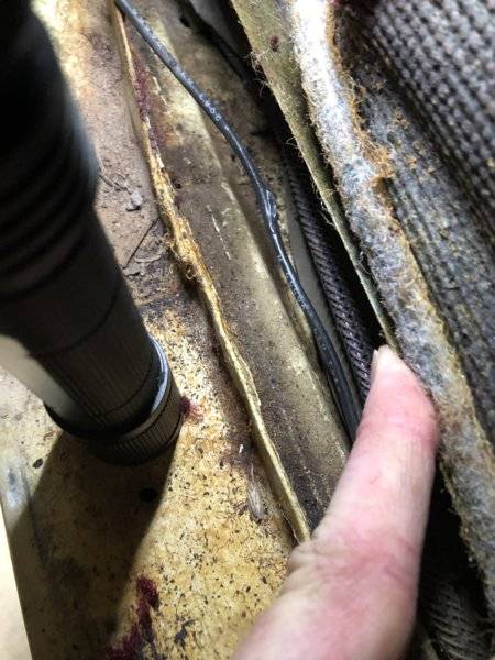

Previously I found a pink line that was burned up. I removed the driver kick panel to inspect the 6 way connector. It looks good. I have found however that the line that was burned up did not route through the 6 way but went from pink to black and routed along side but not with the encased wires from the harness. I am trying to identify this wire. The origin of this wire is not known but I believe it was directly from the fuse box pink set.
DB1267B0-4EBB-4988-A273-8B5BBEF48605.jpeg 2B7EE917-54CA-4CBA-86B7-6A3F7008FB75.jpeg FF9B2AEA-5A4F-4C27-B385-C189142FC956.jpeg 4A901DA6-6C2E-4E9B-BE71-22BB3C3C207E.jpeg
That pink wire goes to the overhead dome light, if I remember correctly.
The blue wire in that connector is the fuel sender.
Yellows go to door switches for the dome/console lights.
Thanks PB OK I had to rip up glued carpet to trace the wire. It ran all the way to the trunk and is the trunk light lol. Not sure why it burned up. But that question is now solved.

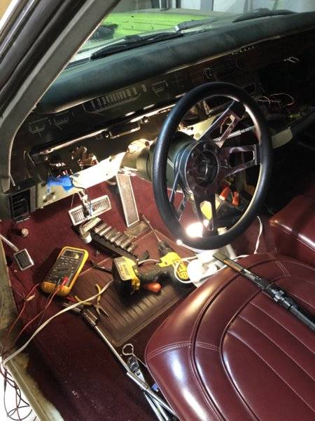

OK no dash electrical or rear tail lights. Looks like I have to get into the dash darn it. I have to drop the steering column to do that as well. Fun fun fun.

Check the run carefully, especially if there is rust damage in the trunk area or behind the rear seat. Mine wasn't burned up but was grounded out from having the insulation rubbed off in the area of some rust. The fuse to mine was removed which shows there was an issue with it prior to me rebuilding it.
You KNOW that pink wire shorted somewhere, so the easiest/cheapest way to deal with it is to just run a whole new wire, connect it on both ends & just leave that pink wire in there (un-hooked).

Guys thank you. I have the factory manual and schematics. I couldn’t even if I wanted to reuse that pink trunk line lol. PB thanks for the suggestions!! I did look for voltage at the 6 way connector behind the kick. No voltage. This is why I am looking behind the dash. After I dropped the steering column and pulled the plastic dash off there is still a sheet sheet metal sub dash there block ease of access and visibility to all the wiring. Its a lot of fun lol

Hi 72 RR Understood. I have the dash and light switch out. All my exterior lights have been removed but I can measure the voltage at some of the exterior light plugs (at least the ones that have not been previously cut). Will try and do that tonight.
No gauges no radio nuthing but the oil light in the ignition 1 position. No running lights no dash lights no dome light voltage.
It’s got to be something basic with all this not working.
Is the voltage limiter mounted to the PCB in a can? Is there a better way to get to the PCB? Its a PITA!

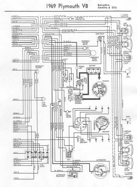

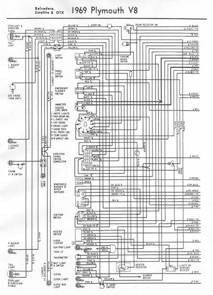

Well the good news is I think I found the problem.
The bad news is its a lot of missing connections. Over the years and a lot of Bubbtization lines were cut and spliced and not connected correctly or not connected at all or respliced with the wrong color wire. I found multiple wiring issues at both the dimmer switch and headlight switch. It totally explains the isses I have been seeing. These are the points of distribution from the schematic.
Now in order to fix it I can get a new harness or try and splice in the missing and chopped wires.
