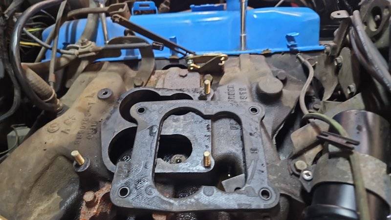

As luck would have it a guy posted in UK Mopars a set of used exhaust manifolds for sale, managed to secure them for £180 which was a good deal considering it would have cost around £500 for just one side from the US.

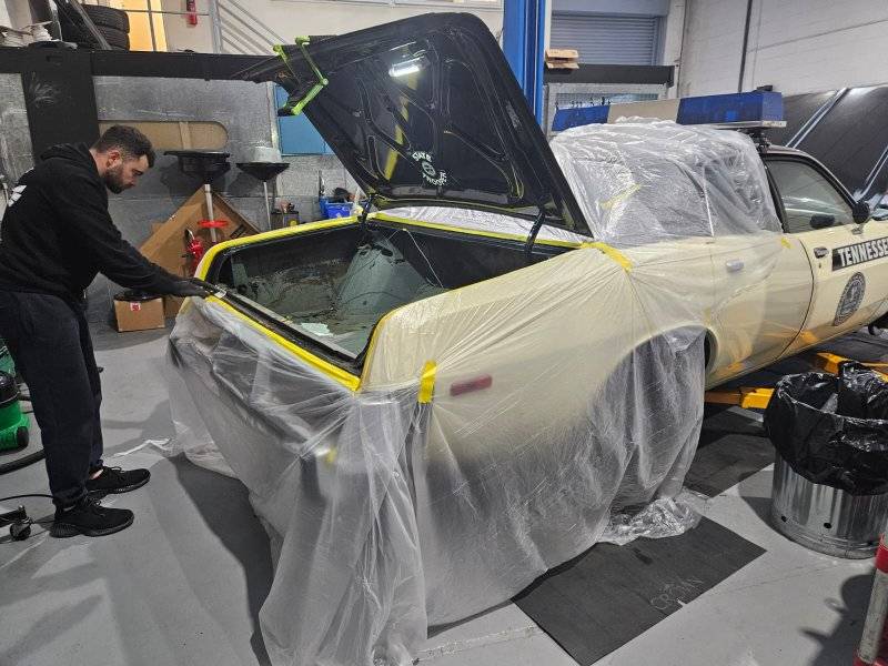

Manifold is on, no leaks, good vacuum, engine misfire sorted, chassis is rust protected, trunk is repaired and rustproofed.

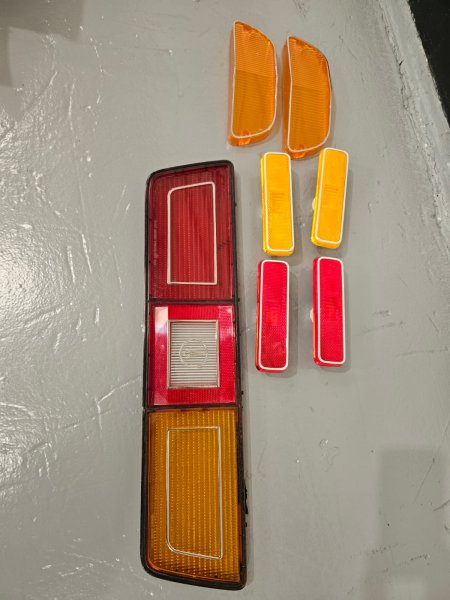

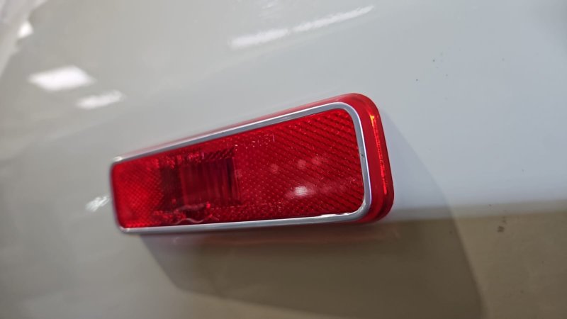

New tyres on, new front and rear fender marker light lenses, new front idicator lenses, one new and one very good condition second hand taillight lenses on.

Trunk seal to install.
Underside of hood to be
painted.

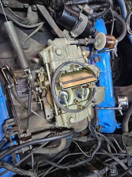

Carburettor undergoing rebuild, it's dumping too much fuel in the secondaries, may need a new one.

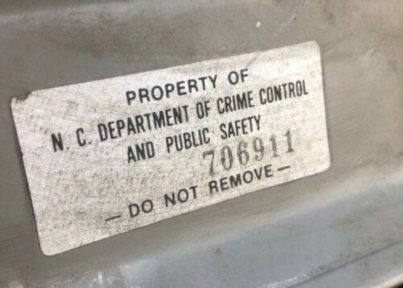

It looks like it is going well. Is it a real Tennessee patrol car from days gone by?
It is a genuine ex police car but it actually served with the North Carolina Highway Patrol.
It was bought by an Ex Tennessee State Trooper and lots of money was spent to transform it into a Tennessee tribute car.
Are the tags still attached to the car? Your car might have 2 or 3 tags.
