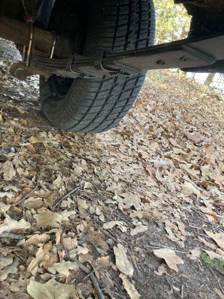

My other question for the readers is, for proper leaf spring action to get the car to hook up, should I remove all the leaf clamps behind the axle, and possibly add more to front?
Im not sure what the plugs thru are, possibly alignment hole from factory? Don’t appear to be rivets.
(ESPO Springs have 2 clamps in front and 2 in rear) see attached photo.
