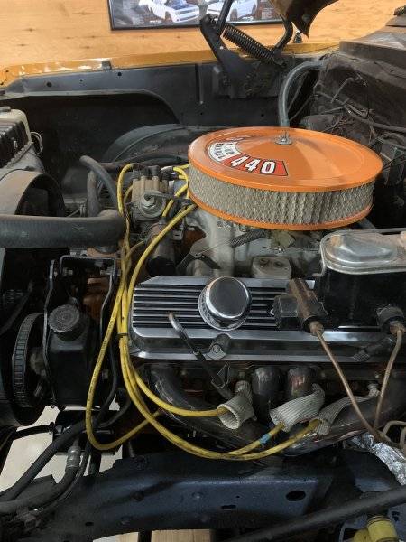

I replaced, unsuccessfully, the rear main seal. It’s a 440 engine. The truck has sat for six weeks but I continue to have oil collect in the bottom of the bell housing. So a couple questions.
For it to collect there it would have to be getting past the rear main seal and draining back the shaft wouldn’t it?
But is the oil in the pan deep enough for that? Is at least part of that seal sitting in oil at all times? I didn’t think the oil would be that deep in the engine.

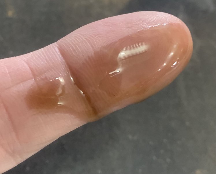

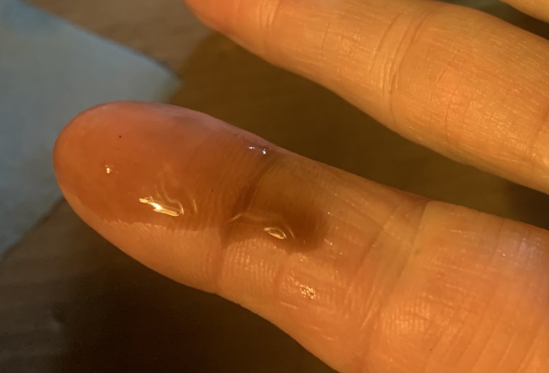

@1 Wild R/T Thank you. It's not transmission fluid, it's not red, it looks exactly like engine oil. I'll swipe my finger on the bottom of the bell housing and post a picture. It's an automatic transmission.

I wiped the bell housing this morning, it’s been 5-7 days.

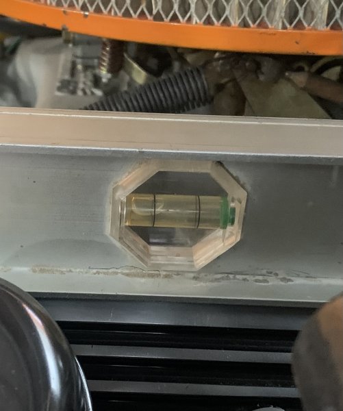

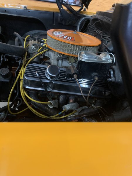

One thing I find about these discussions is that it focuses me on what’s going on and I’ll pause and just look trying to figure out what I’m missing. This is on a Power Wagon with a 727. The dipstick is reading about 5/8” above full. Also the engine is tilted slightly to the back so maybe between those two things the seal is partially sitting in oil. The shop floor is slightly sloped which might add a bit to the position of bubble in the level.
If it looks like oil, feels like oil, smells like oil and tastes like oil.
Then it's probably oil.
