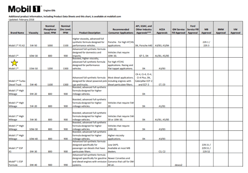

Not a lot of people know this, but Mobil 1 15w-50 is one of the few synthetic (non-specialty) oils that is formulated for flat-tappet camshafts. No need for additives. HT/HS* (High Temperature / High Shear viscosity)
$22.88 for 5-quarts at Walmart.
This was discussed in another forum. Either Mobil One is lying about their data or it is not SN graded oil. Could be an older data sheet but it cannot have that amount of zinc to be classified SN.
Date sheet was updated February 2018 :thumbsup:
Factual information provided in that 'forum' from multiple tests or just hearsay?

I hope you are right as a high zinc off the shelf oil is nice to have. Mobil 1 use to have higher zinc content in their high mileage oils until they became SN rated.

I just confirmed what I mentioned earlier. In the API Certification document, they set the phosphorus limit for (SN) viscosity grades 0W-16 through 10W-30 at 0.08%. All other (SN) rated viscosity grades have no required upper phosphorus limits. Basically, anything in a 40, 50 grade can have higher ZDDP as long as it’s not “Resource Conserving”.
