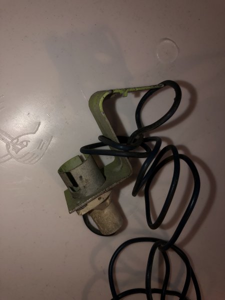

When I bought my Road Runner many years ago, it had a light similar to this one under the hood, not connected to anything. That light is long gone. Now, I have this similar light socket. Is an under-hood light an option in a 70 Road Runner? Where does it get installed on an air grabber hood? How is it wired in? What turns on the light? I do have the A01 light package option if that matters
THANKS!
I’ve never seen that on all the 70’s I’ve ever seen but there could be but most like not
No, never for 1970.
that is late 70's mopar light,
THANKS!
There are generally two ways to activate the light; either a mechanical switch similar to a door jamb switch, often used in trunk lights, or a mercury switch that completes the circuit when the bulb/switch and bracket are tilted up past a certain angle.
