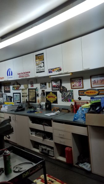

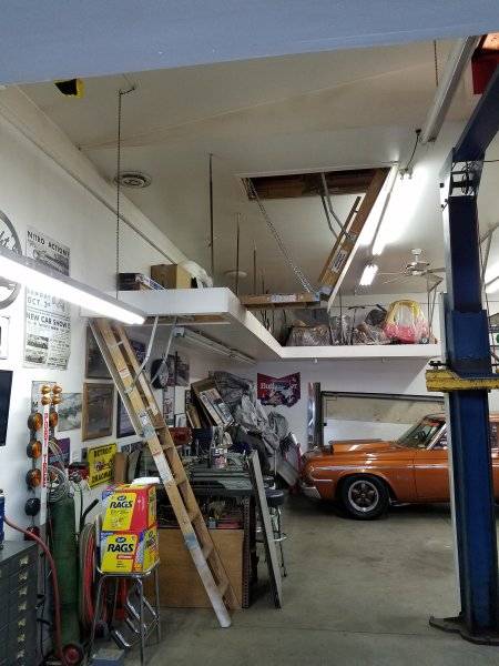

Mine is 40 wide 24 deep. 3 bays, 1 with a hoist. the remaining area has a full counter with upper cabinents and a sink. There is enough room in front of each stall for the blast cabinent, drill press, mig welder, lathe, bolt cabinent, tool box, and tool cabinents. Even with only 3 bays torches, oil drain, trans jack is stored in between bays. Above the work area is a 24×8 enclosed storage area. There is a swinging hoist and electric winch that will raise engines up into it. There are dual stairways to gain access to storage of 4 foot wide shelves and an upper storage area above the bays. It would've been great to be 1-2 ft deeper but it's the max sq/ft we were allowed. If you are going to actual work and have a lot of tools no way 4 cars will fiy comfortably. Even my extended cab dually will go up on the hoist. But I have to slide the bolt cabinent and tool box over. I do a lot of work out of mine along with rotating 3 hotrods between the shop and the enclosed trailer. Can be a little snug at times but It's more area than a lot of people have.

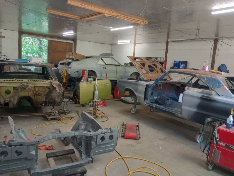

there are 5 full size cars in this picture lol
