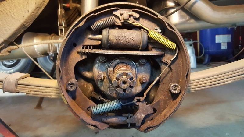

You cannot do that, the housing ends and bolt pattern is different. Brake backing plates have the different bolt pattern also. Have to change the entire rear end.
why don't you just run with the tapered axle? Put new brakes on it, repack the bearings and new seals in the housing. Done deal. They do work just fine, especially with your 318 street car.

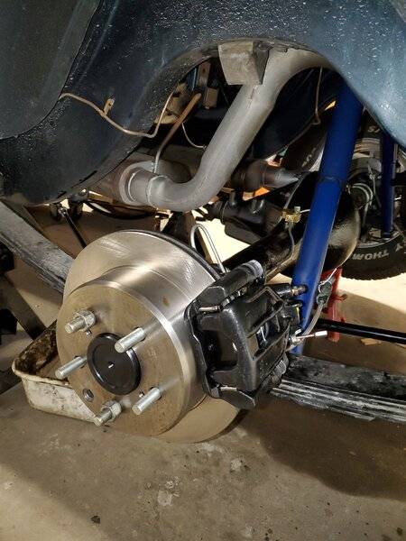

I am running a '63 rear in my '64 now. New axles from Dr diff along with rear disc brakes and the original '63 3.23 pumpkin, no issues.
Later drum backplates would have to be used for drum brakes and just bolt up.

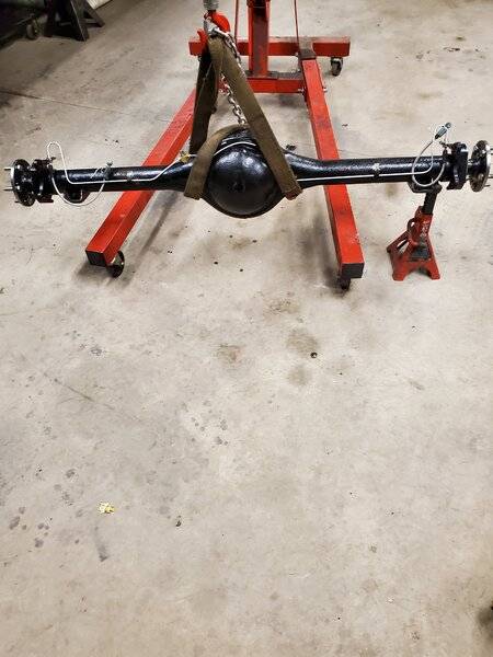

See @khryslerkid 's thread where he upgraded to new axles and runs drums on his original housing and suregrip.

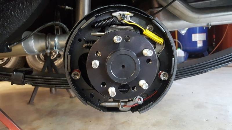

Here's how it's done...
https://www.forbbodiesonly.com/mopa...p-new-residence.114133/page-11#post-910731376
I even made the fronts removable drums also.

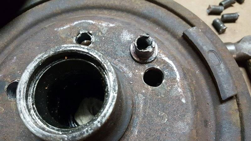

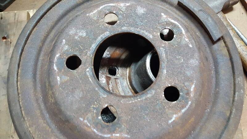

Yes but the holes left behind from removing the swedged studs are not very round in the drum. They'll fit a little sloppy.
Here's a drum that I drilled the swedged studs out. I never touched the drum with the drill bit. The swedge deforms the hole when they install them.
Yes, but the drum centers on the center hub. Once the lugs are tightened the size of the lug stud holes is irrelevant.
Some fit snug some dont. Each stud also has a shoulder that helps with the drum fitment. Use it if you have too.
